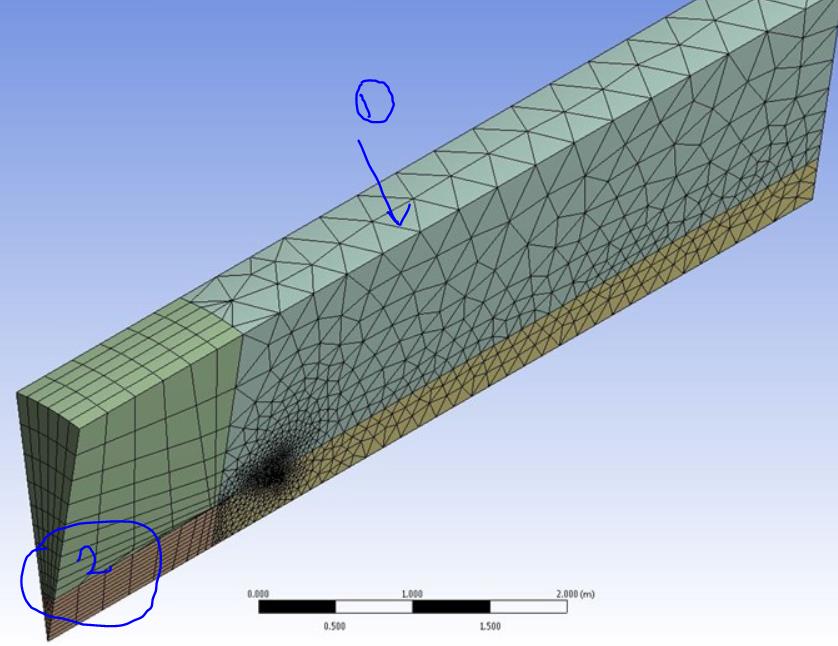

Hello Chad,
Your mesh is really bad. If you check the mesh on top surface marked 1, you have only two cells and the region I marked 2 is also not recommended. You might be having very high skewed cells in that region. Can you do the mesh check in Fluent? will the mesh pass the mesh check?
