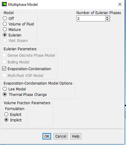

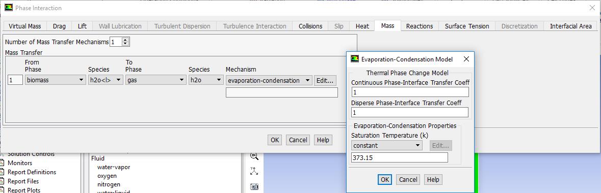

Which model is suitable then for drying, because for Lee model, experimental data is required to adjust the coefficient and there is no calibration required for the thermal phase change model.

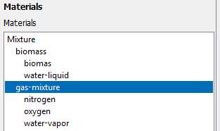

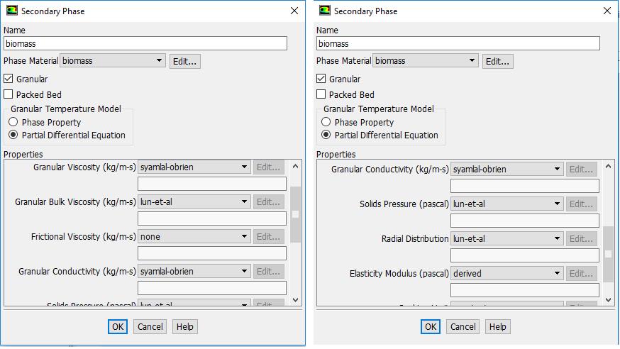

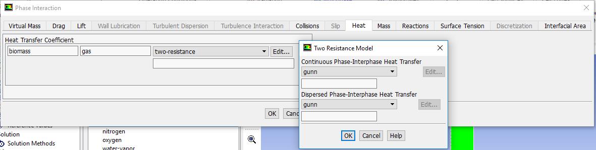

Here biomass is a mixture of biomass and liquid water. Drag correlation used  is Gidaspow'sBiomass granular phaseheat transfermass transferMixturesmultiphase model
