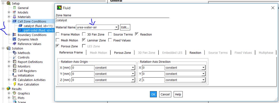

As klu mentioned, there could be an issue with the assigning the right material for all the zones. All the zones should be a mixture material.
In the above picture, material name is a mixture material name. Similarly you should have the same materials for your cell zones.
