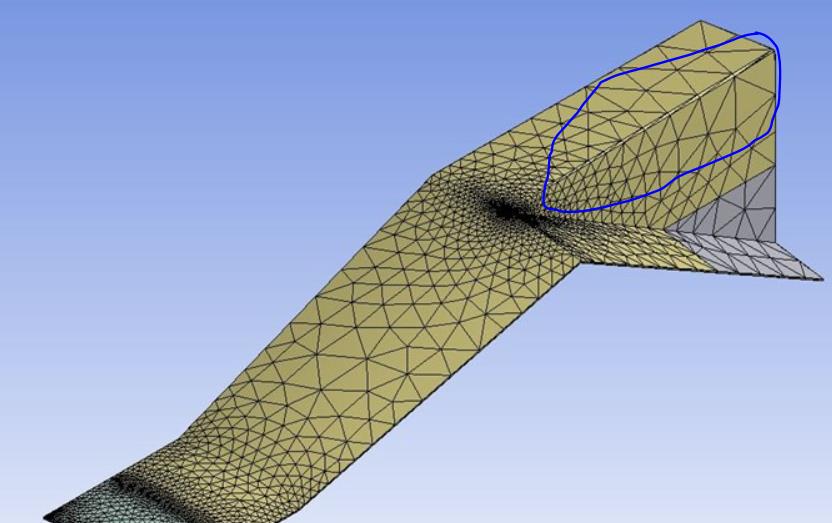

In the second picture of your mesh, I could see the skewed cells. What is the maximum skewness of your mesh? fluent will report orthogonality. Is it with in the limit?
At the end of the edge, I could see again two cells. You need to refine further and check for skewness at the marked region.
