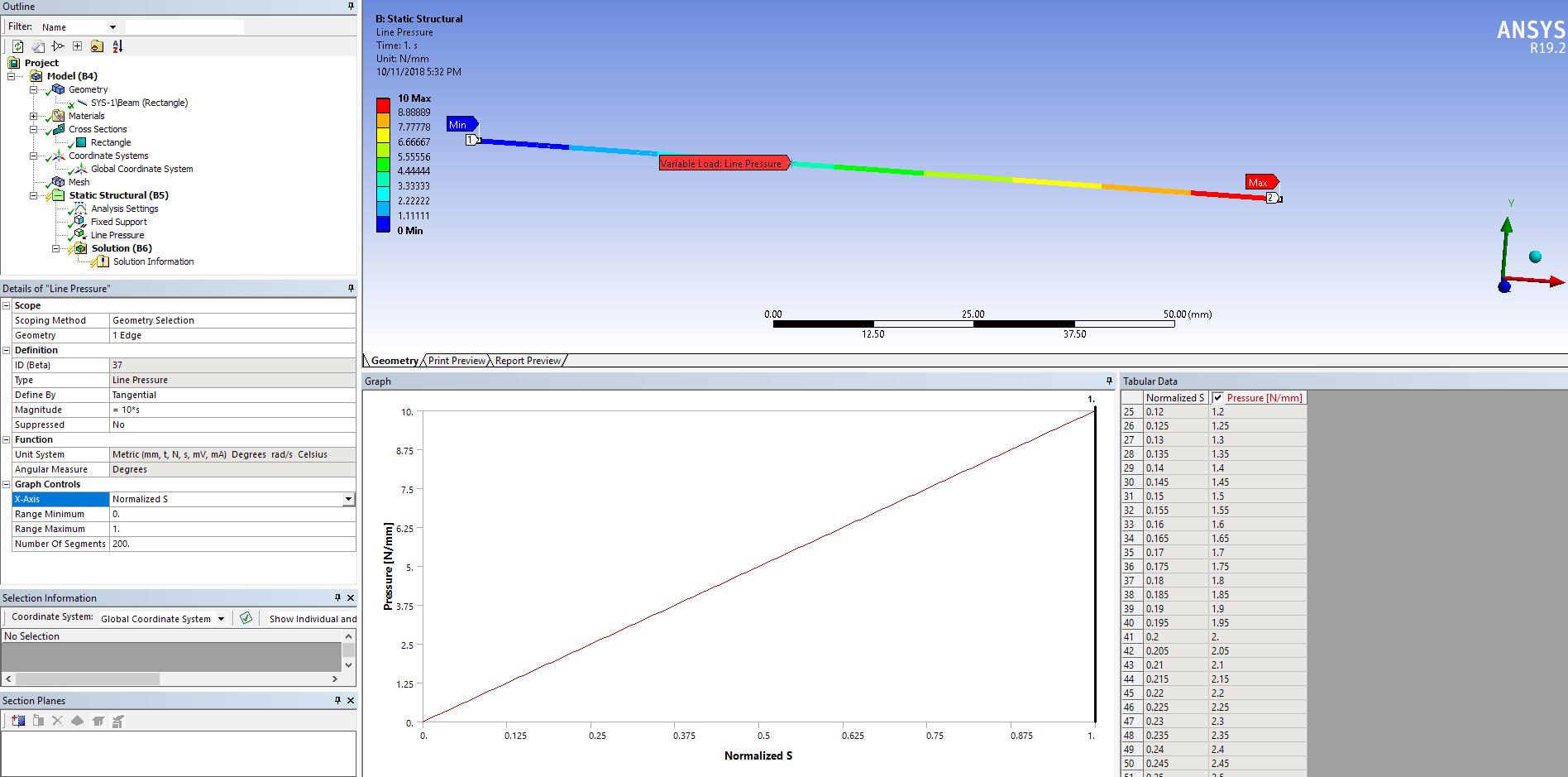

  You can apply a spatial varying load or displacement by either using Tabular or Function inputs in the details view. Please see this section of the help.
  Also, what version and software are you using(Mechanical or APDL)?
  As an example, I created a simple line body in Mechanical and applied an uniformly varying line pressure, i.e., the relation is 10*x. You can see how the data/pressure load is tabulated on the right.
