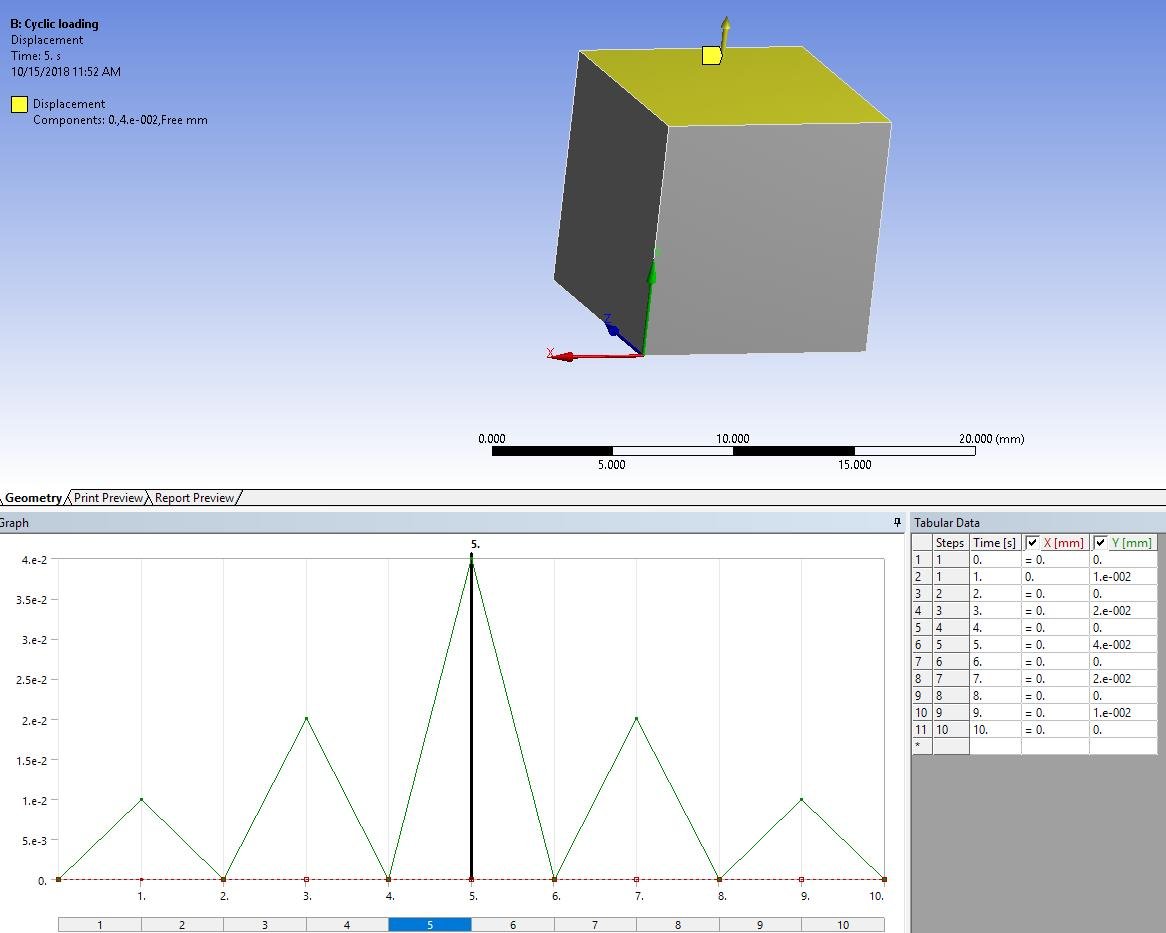

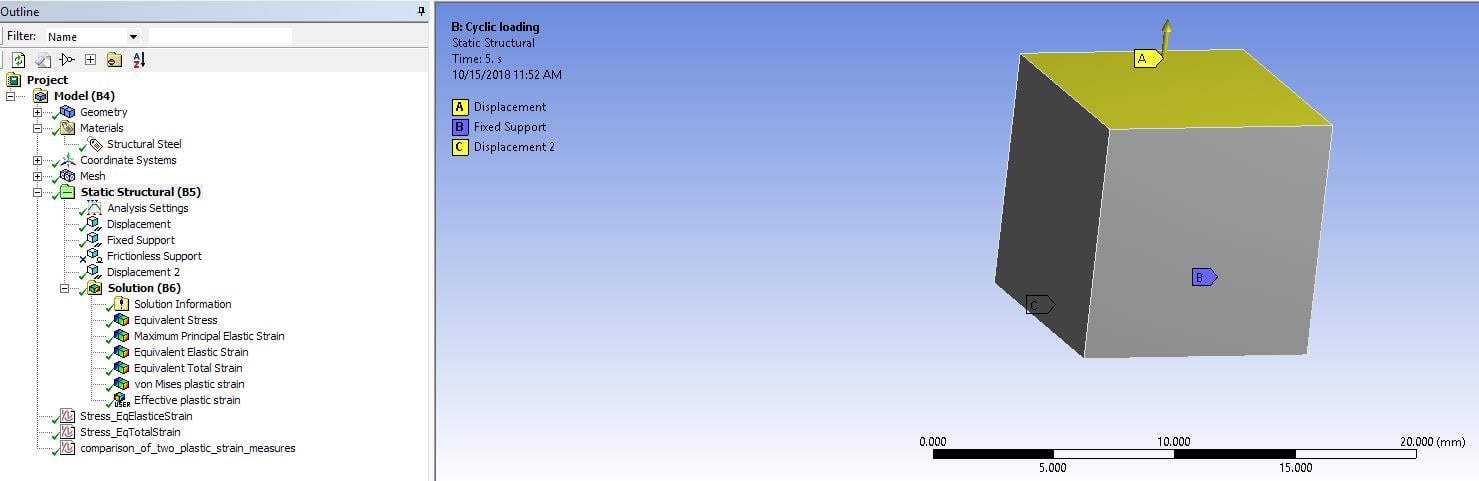

I am struggling a bit to understand the German words in your model. So I've just, checked this on a simple single element model:
subjected to cyclic loading:

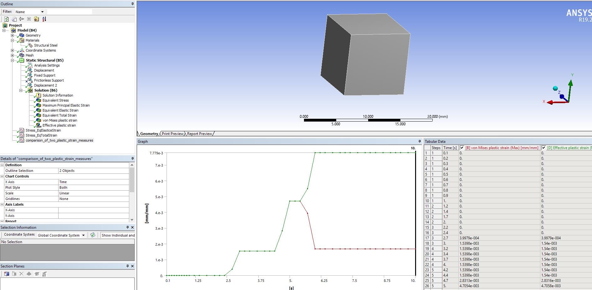

and I see a clear difference between the von-mises plastic strain and the effective plastic strain:
Hope this helps.
