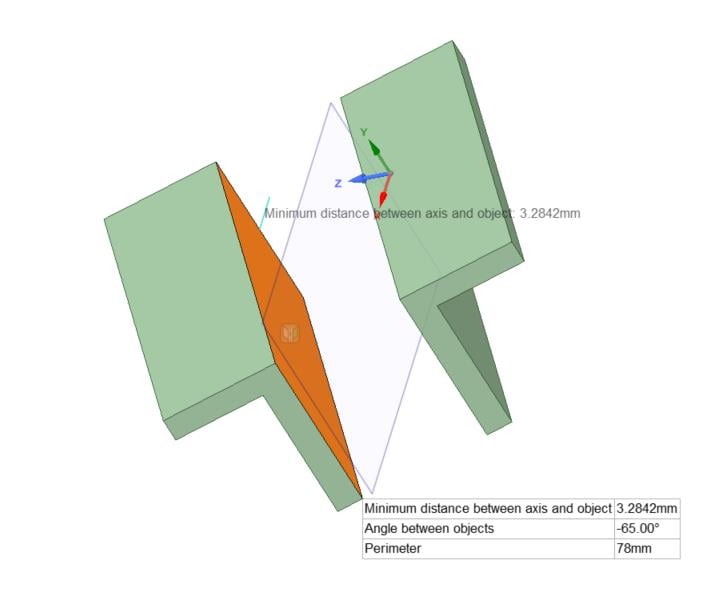

Switch back to 3D mode and use the measure tool to estimate the angle between a plane and any axis.
In my case, I am selecting the highlighted plane and Z axis and the measure tool estimates the angle (attached screenshot).
Then you can use the move tool to rotate your solid bodies based on the measured angle.
I hope this helps.
