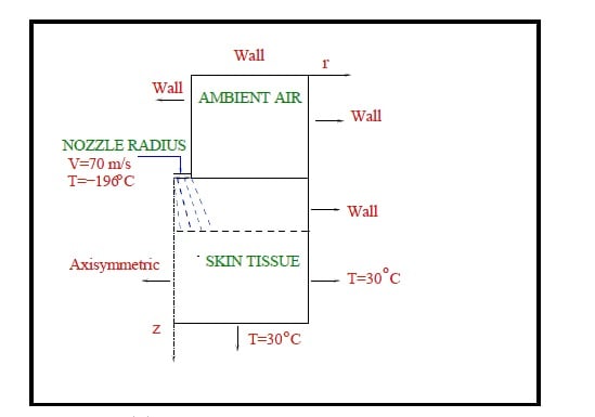

i am  attaching the geometry and properties
kindly specify how to model this,i have planned to use second order upwind, with pressure correction scheme.k-epsilon turbulence model and energy equation would be solved simultaneously.is their anything else required?nozzle hole is 0.8 mm.
