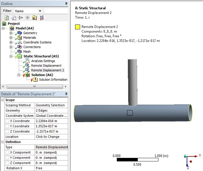

Check your inputs for reasonable values. You have an obvious mistake in the displacement you input, it is 305 km!
Delete Remote Displacement 2 because you have used 2 edges. Create two separate Remote Displacements, one at each end with one edge each.
