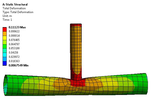

Two other changes, under Analysis Settings, turn On Large Deflection and turn On Auto Time Stepping and set the Initial Substeps to 10. Here is the result for a displacement of 0.1 m.  I recommend using smaller element size in the mesh. This mesh is too coarse.
