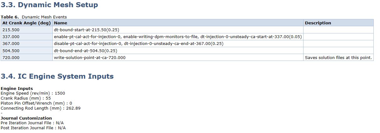

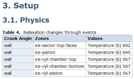

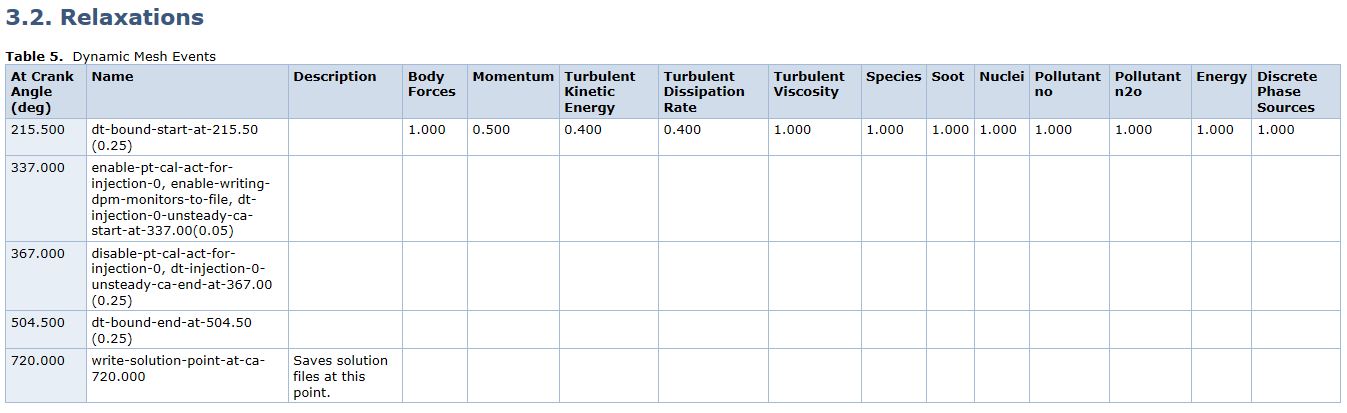

This is the screenshots of my Setup parameter which is mention in the report.
Sir, please inform me, if any other data which is required to easily understand my problem and suggest the appropriate solution.
