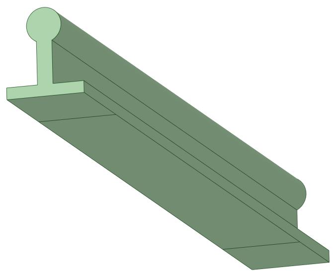

Here is a rail with the bottom surface split at the two locations where, in the lab, the rail will be supported on cylindrical steel rods instead of a wide wooden sleepers. The rail is along the Z axis.

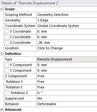

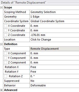

Here at the two Remote Displacements, one applied on the front, the other the back split line.
