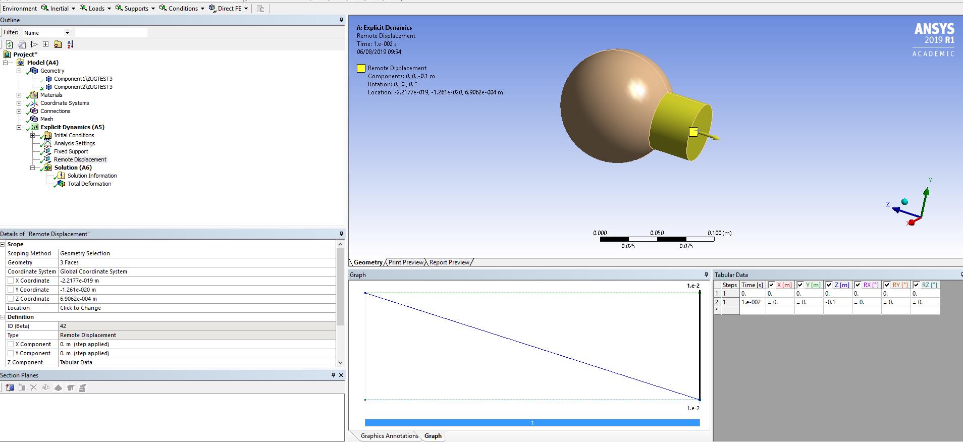

In explicit you have few cycles so it can not run the 10 s.
Just to see that it works I reduce the final time to 0.01 s, and then increased the number of cycles to 1E8 cycles.
With that and making the part that you pull shorter, because other wise that part will just stretch, it solves fine in explicit.
