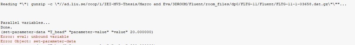

Im using AAS- to couple Matlab and Fluent and use it as a Server. I have followed the steps in the official Ansys Youtube tutorial for the connection, and have read the users guide: "Fluent as a Server".
Most of functions seem to work such as: tui.doMenuCommandToString(), fluent. getNrInputParameters(); fluent.getInputParameterNameByIndex(in long lInputParameterIndex);
Nevertheless, the most important functions that I need do not work: (WRITE AND READ PARAMETERS of Fluent)
fluent.getOutputParameterValueByName(string('q_rad_thorax'))
fluent.setInputParameterValueByName(string('T_head'), 200)
I write an example of what Im coding:

MATLAB OUTPUT ERRORS:
>> fluent.setInputParameterValueByName(string('T_head'),200)
Java exception occurred:
AAS_CORBA.EFluentGenericError: IDL:AAS_CORBA/EFluentGenericError:1.0
at AAS_CORBA.EFluentGenericErrorHelper.read(EFluentGenericErrorHelper.java:80)
at AAS_CORBA._ICoFluentUnitStub.setInputParameterValueByName(_ICoFluentUnitStub.java:456)
at AAS_CORBA._ICoFluentUnitStub.getOutputParameterValueByName(_ICoFluentUnitStub.java:579)
PD: I have already written in my Fluent case these parameters previously, so they exist. I have also tried writing fluent.getOutputParameterValueByName('q_rad_thorax') and neither works. Here below I attach the error that I get from at FLUENT command window: unbound-variable, set-parameter-data
