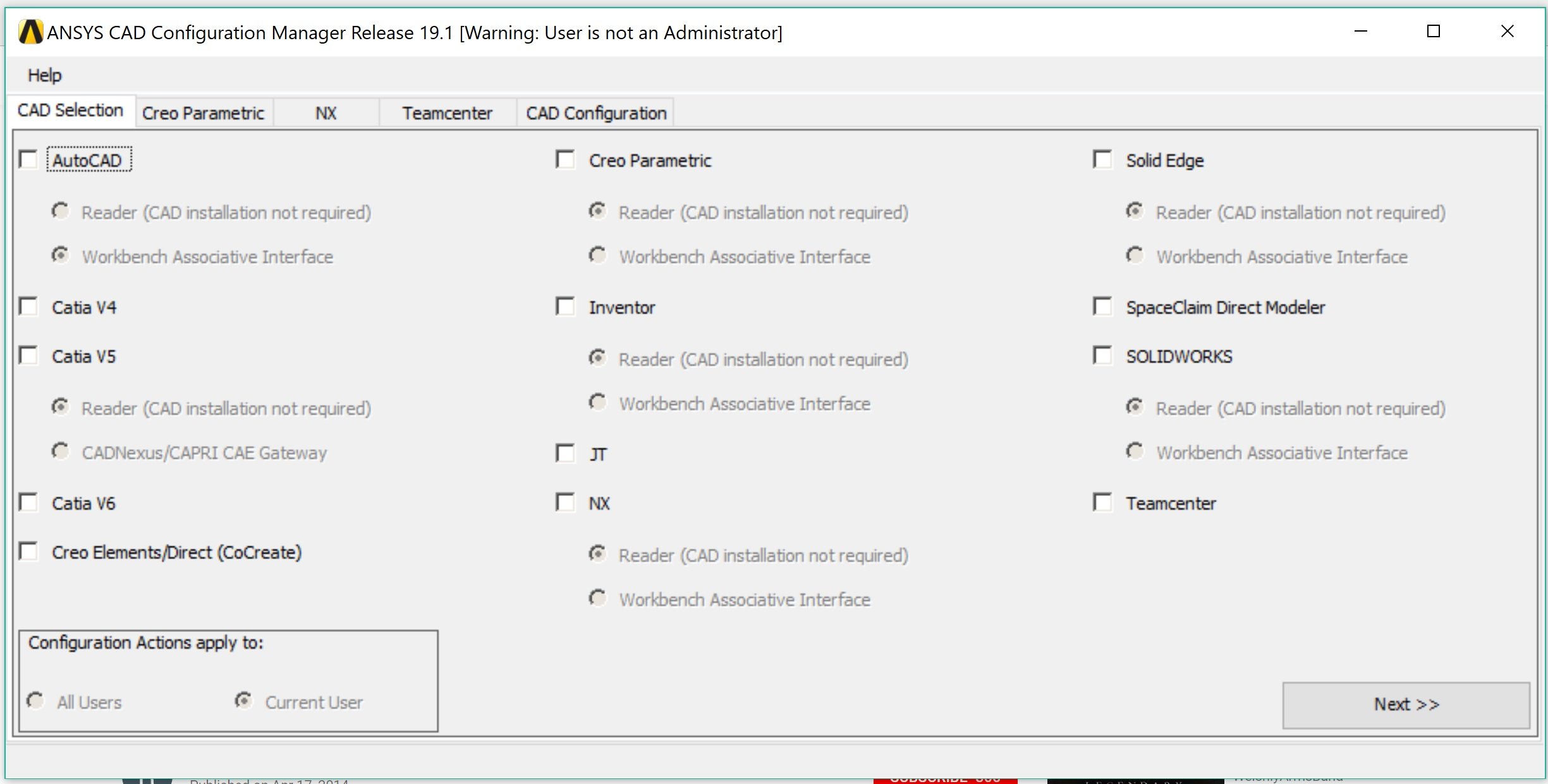

ahmedBadawi
SubscriberHi Aniket,
This what I get when I click on configure products and cad. As you can see in the attached image, nothing is displayed. Any ideas?
I also followed the steps mentioned in this thread by tsiriaks , yet the problem persists.
https://forum.ansys.com/forums/topic/ansys-19-1-on-mac-the-geometry-editor-was-closed-abnormally/
Thanks!
July 2, 2018 at 7:26 am
Aniket
Ansys EmployeeHi,
I think you are using Product and CAD configuration manager, instead, you should just use CAD configuration manager. Regarding Gary's suggestion, you should be able to find the License manager for R19.1 in the setup of the R19.1 itself.
July 2, 2018 at 12:29 pm
July 2, 2018 at 2:13 pm
Gary Stofan
3rd column, 2nd checkbox down. "SpaceClaim Direct Modeler"
