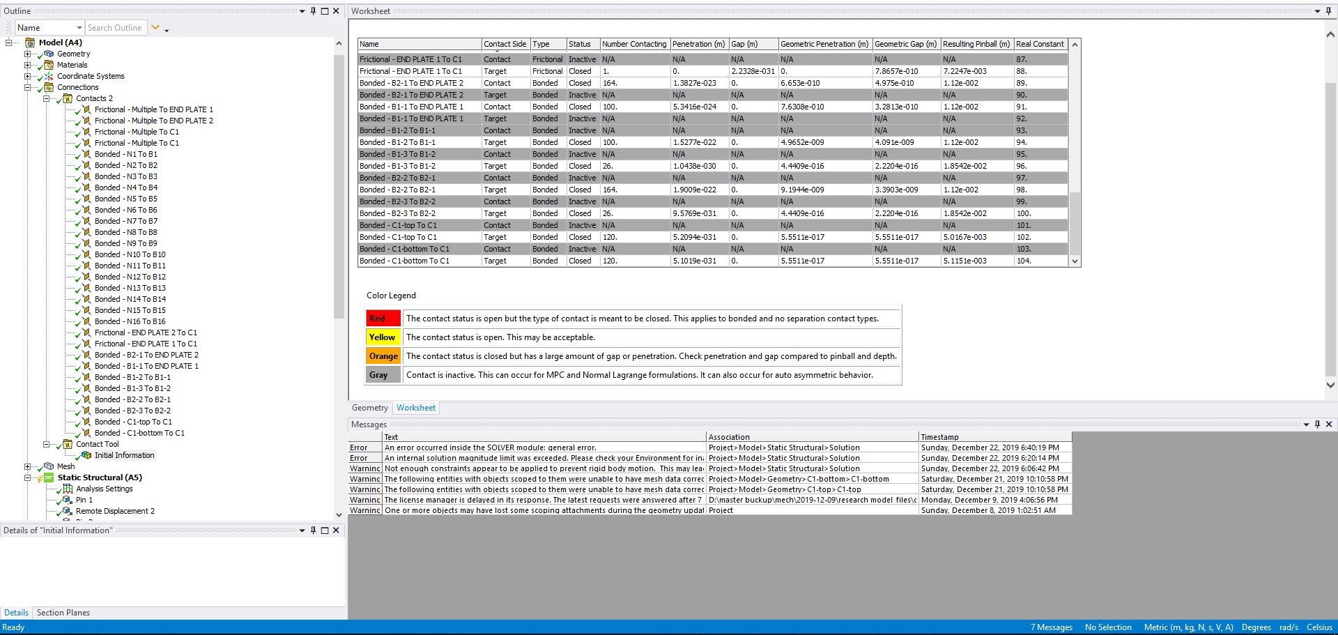

Subscriber@peteroznewman after I applying your steps for boundary condition and check the contact using the contact tool I get the following error:
1-Not enough constraints appear to be applied to prevent rigid body motion. This may lead to solution warnings or errors. Check results carefully.
2-One or more objects is using a deformable behavior but is applied to a collinear set of nodes. This is not recommended and can cause solver difficulties. Check the Solver Output on the Solution Information object to identify the offending load.
3-An internal solution magnitude limit was exceeded. Please check your Environment for inappropriate load values or insufficient supports. Please see the Troubleshooting section of the Help System for more information.
4-An error occurred inside the SOLVER module: general error.
then the model fail.
December 22, 2019 at 2:36 pm
Subscriber1- is a warning, not an error.
2- is a warning, not an error.
3- Did this happen on the first substep? If so, insert a Contact Tool under the Connections folder and Generate Initial Contact Status. Open that to look to see that all the contacts are closed. Reply with an image of that table.
4- Solve problem 3 first.

SubscriberMaybe warning #2 is the source of the problem. Things are a lot easier if you make two slices and use 1/4 symmetry. That immediately takes away 5 DOF, therefore, as long as you constrain just one point in Y, you might resolve this error.
Next time you have a Contact Table, click on the Status column heading and group all the inactive rows together, you don't need to show those and it will cut your screen grabs in half.

Subscriber@peteroznewman i follow your steps and create two symmetry plans but I still have the same error:
model link: https://we.tl/t-KszIiIpMpT
December 24, 2019 at 2:22 pm
SubscriberYou split the face of the fastener, but you didn't move the Bolt Pretension to the face between the head and the nut.
The image on the left has the Bolt Pretension on the face that is bonded to the nut. Wrong.
The image on the right is the correct fact to use Bolt Pretension on.
You didn't change Step 1 to Auto Time Stepping with 100 Initial Substeps. Change the Solver Type to Direct.
I suppressed the body at the tip of the arm, past the Pin1. It is not necessary.
Under the Solution Information folder, it is best to have non-zero values, like 3, for Newton-Raphson Residuals and Identify Element Violations. They create useful troubleshooting data if the solution doesn't converge.
It is faster to do troubleshooting on just one bolt, since that is where the problem seems to be. Suppress all bodies except these four.
When you solve, you will find the END PLATE 1 is what blows up. If you change that part material back to Structural Steel, you will find this small model converges.
The conclusion is there is something wrong with the end plate material.
The problem is that the units were set to Pa while the numbers you are using are in MPa so you are off by one million.
You have the same problem in all your materials except for Column Structural Steel. That has the proper number to match the units.
