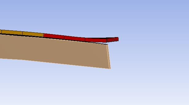

SubscriberIn my actual model [Fig 1], the load is applied (in substeps) at the edge in z-dir; the purpose is to make the pane fit the arched solid part [Fig 2] and check stresses. Since, i don't know the exact necessary load for this, I wanted some help in implementing either of below:
- apply load till the edge of the pane touches the arched mold, OR
- apply displacement (it should be in steps as well) till two bodies touch (or to a certain small distance)
Any suggestions how to do it?

Here is my suggestion: Create a rigid rod above the pane. Define contact between the rod and the pane. Create a translational joint between the rod and ground that guides it along the Z axis. A force on that joint pushes the pane down. If the force is large enough, the pane will be squeezed between the rod and the mold at the end of the simulation.

SubscriberHello jonsys,
I recommend you just build the model to follow reality more closely, and apply the load gradually (Minimum Substeps) to a small area, like along the edge of the glass.
One way to find L0 using the rod is to use a Joint Displacement instead of a Joint Force as the Joint Load. You know from CAD how far to move the rod to become tangent to the pane on the mold. Just type that value into the Displacement. In the Solution, request a Probe of the Joint Reaction Force and it will plot the force in newtons or lbf directly as a function of time.
Using the Rod method with a force, the load ramps on in substeps, so if you configure the Analysis Settings to have Minumum Substeps 100, then you will get all those results and the one that shows the pane making final contact is the time step you want. Let's say you create a force of 1000 N on the joint and 100 Substeps to get to Time 1. At Time 0.56 you observe the final contact is made by inspection of the deformation, or plotting the contact pressure. The rest of the time is just squeezing harder. So L0 is 0.56 x 1000 or 560 N.

By rod, I mean a cylinder, which is one of the primitives, or you can just sketch a circle and extrude. The rod would be above the glass lined up with the lowest part of the mould. The rod would have frictional contact with the glass, because the glass would slide across the rod as the rod moves vertically down on its translational joint. The rod stops when it has traveled a distance that brings it tangent to a curve offset from the mould by the glass thickness.
If you drag the joint from the connections folder and drop it on the Static Structural branch, it will add a Joint Load.

If you assign a frictionless contact between the rod and the glass, then that would be like allowing the rod to rotate on a low friction bearing in the physical world, though there is no need for the rod in the model to rotate, you just assign frictionless contact.
The model I provided above does not converge to the end, I was concentrating on trying to get the distance calculated in DM out to Mechanical. You might need more steps to get convergence.
Driving the pane down with a displacement is preferred for convergence, but if you input a distance larger than the distance at which the glass makes contact with the mould, the solver will fail to converge past that point. Therefore, the last converged increment is just before contact is made. If you make the maximum number of substeps a large number, you can force small displacement increments into solution, so the final converged increment is very close to a clamped position. Since you will be plotting the reaction force on the rod displacement load, you will know the force to push the glass onto the mould.
The problem with a model that fails to converge to the End Time, is that the results are not transferred to the Parameter Set table of Design Points. If you check the Retain box in the third last column of the Parameter Set, you can manually open each solution and extract the force from the last converged time increment.
To avoid that, there is a sequence of steps that could work. Use a Force load on the rod to push the pane and clamp it to the mould. At the end of that time step, activate a displacement BC on the rod that was inactive during the first time step. There is a command snippet to hold a node at its current value. Then in the next time step, you could move the rod up 1 mm and that way relieve the clamping force of the glass to the mould, and be left with a reaction force on that displacement constraint that is just to hold the glass down 1 mm off the mould. You can even track how the force changes over that 1 mm and you might see a change in slope where the contact is relieved. Maybe a much smaller displacement would be better.

But firstly I would like to clarify something: In the picture shown below, the rod is placed exactly in the same line with the end of the mould. But in cases like this where the radius is small, the displacement applied at the rod (fixed to the pane), will not stress a considerable part of the glass pane, nor fit it to the mould. Is this the right approach?
Well, this is of course an exaggeration compared to reality, because such a small radius will make the pane fail.

The rod is not fixed to the pane, it has a frictional contact to the pane and so as the rod moves vertically down and the glass wraps around the mould, the glass will slide on the rod.

SubscriberHello Jon,
If you plot total displacement, the pane has moved down and to the left, while the rod has only moved down. If you plot directional displacement, then the rod and pane will have the same Y axis displacement at the point of contact.
With a fixed vertex, the solver failed to converge and the N-R Residual plot showed me that the element that failed to converge was the one that had the fixed vertex. After I changed the BC from vertex to face, the model converged to the end.
The rod has a small radius with many nodes around the surface on small elements, while the pane is flat with nodes spread out on large elements. The contact algorithm is checking if the node on the contact side is penetrating the surface on the target side. That is much easier to do when the Pane is the Target. If you make the Rod a Rigid body, then it is required to be the Target side. No flipping allowed. Not sure why 17.1 flipped it back. You can set the contact to be Asymmetric rather than Program Controlled and maybe it won't flip it back.
Reducing the contact stiffness is simply to make the convergence easier to achieve. At the end of the solution you take a look and decide if the penetration is acceptable or not. In another model, I set contact stiffness factor to 0.1 and it solved in 75 iterations and showed a visible amount of penetration, but when I set the contact stiffness to 0.5, it took more than twice as long to solve.
The true stress in the glass caused by the contact with the steel rod is not resolved in this model because the element size on the glass around the contact point is way too large. You would need elements small enough to "wrap around" the radius of the steel rod. It is simpler to take the normal force on the rod and build a separate 2D model to evaluate the Hertzian stress of the contact of the rod with the glass.
