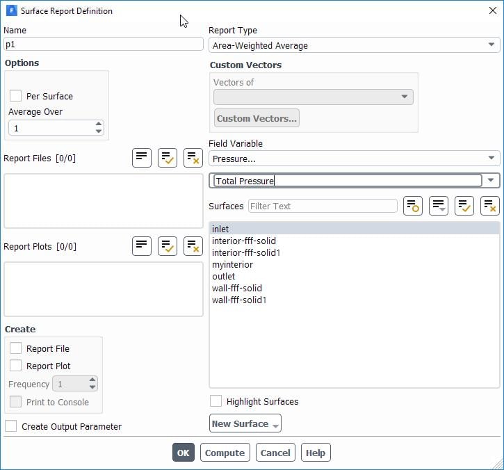

DrAmine
Ansys EmployeeYou can create two report definitions:
Area Average of Pressure at P1 Level and Area Average of Pressure at P2 level then you create an Expression Report Definition which is doing the subtraction and then let Fluent write that for you.
Check the standard tutorials to get started.
July 12, 2019 at 10:13 am
vighnesh
SubscriberPlease attach any source where i can learn about Expression Report Definition. Actually i am very new to ANSYS. Once the points are created what should be done?
July 12, 2019 at 10:17 am
DrAmine
Ansys Employee1/create first report Definition at plane 1. It computes area average of total pressure
2/Same at plane 2
3/Create an Expression type Report definition. Here make the report from step 1 minus report from two. Enable report plot.
Check standard tutorials if you want to learn something. -
July 12, 2019 at 10:50 am
July 12, 2019 at 10:51 am
DrAmine
Ansys EmployeeI hope now is clear: just under surfaces select the surfaces you want to quantify for total pressure difference!
