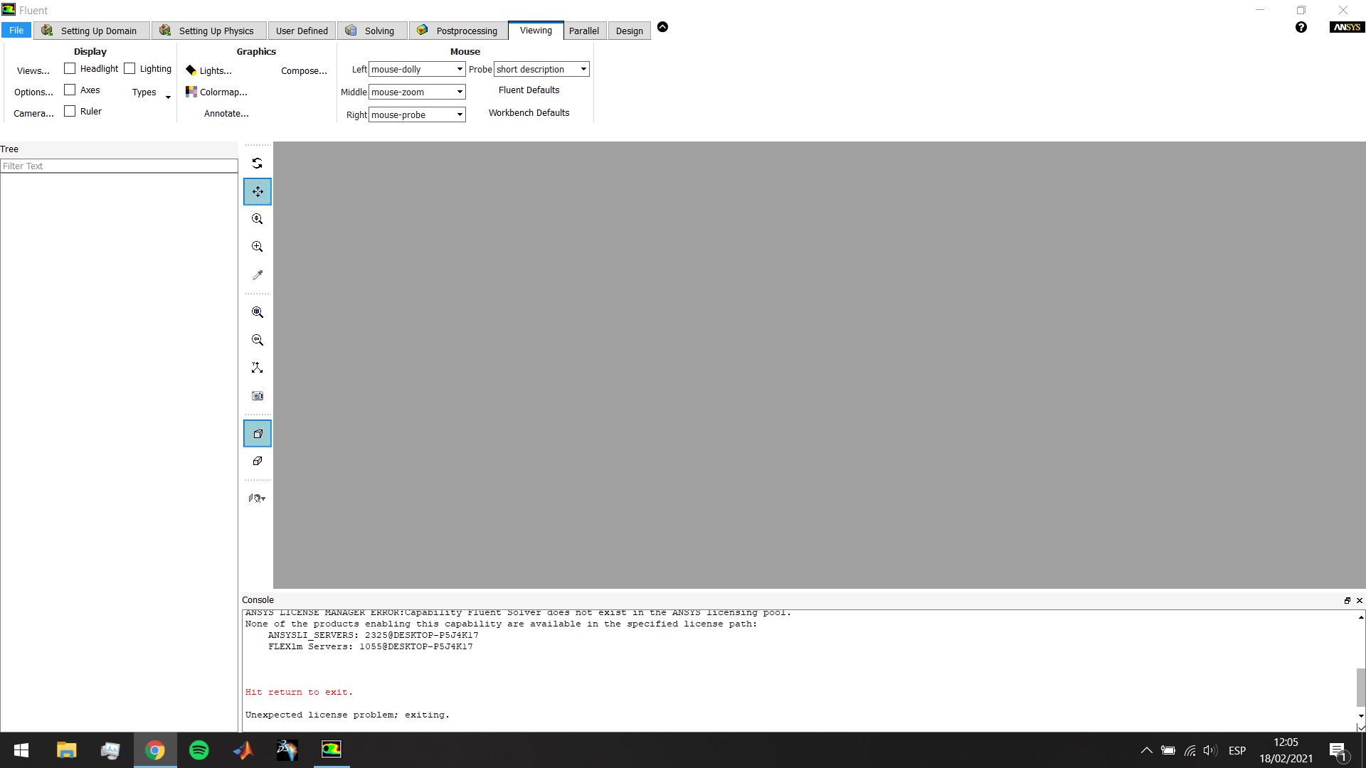

SubscriberI recently changed my entitlements in order to have fluent licences. I unistalled everything and reinstalled again but i still cant open fluent
February 26, 2021 at 5:00 pmANSYS_MMadore
Ansys EmployeeWhat is your customer number? Is the license installed on the machine DESKTOP-P5J4K17? Have you ensured firewalls are open on the licensing ports? Add exceptions for ansyslmd, lmgrd and ansysli_server.nnMarch 1, 2021 at 4:53 pmPRASADK

My number is 1136158nYes, its my computer and I installed it here. The program works fine except fluent. I asked to include fluent licences and i redownlowaded the licence and still appears this errornMarch 1, 2021 at 8:19 pmANSYS_MMadore
Ansys EmployeePlease download a new copy of the ANSYS Student 2021R1 installer and reinstall that copy. There was a problem with the original upload of the installer, which you may have.nMarch 2, 2021 at 7:48 amPRASADK
Subscriber& Thankyou so much, I downloaded the new copy and it is working fine...nViewing 7 reply threads- You must be logged in to reply to this topic.
