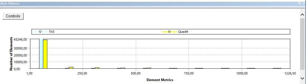

July 22, 2019 at 4:56 pm
abd fs
SubscriberDear rwoolhou,
Following your answer, I want to introduce my mesh quality.
if there are any errors, please give me some tips to resolve these errors.
I received this message always.
Does this message influence the results? If yes, how can I solve this problem?
I would be very grateful for your attention.
Best regards,
SER
July 23, 2019 at 10:44 am
Rob
Ansys EmployeePossibly: it depends where the high aspect ratio cells are. Click on "Controls" in the graph and alter the scale. Then pick the highest few columns and see what's going on.
