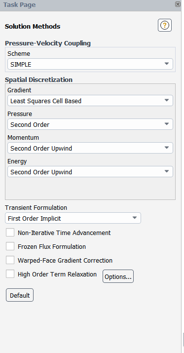

AdministratorYour model doesn't seem to be converging properly. Also, provide some screenshots of your convergence strategy - Time-step, solution schemes etc.nKarthiknFebruary 9, 2021 at 6:30 pmrads
SubscriberYour model doesn't seem to be converging properly. Also, provide some screenshots of your convergence strategy - Time-step, solution schemes etc.Karthikhttps://forum.ansys.com/discussion/comment/106180#Comment_106180

AdministratorPlease estimate the time-step to make sure that the CFL number is ~1. It depends on the velocity and smallest grid scales.nCFL = del_t * V / del_x ~ 1nI agree with 5 s is too large a time-step.nKarthiknFebruary 10, 2021 at 10:31 amrads
SubscriberChanged the settings to adaptive time control with CFL -based. It worked. nThanks everyone for your help!-
