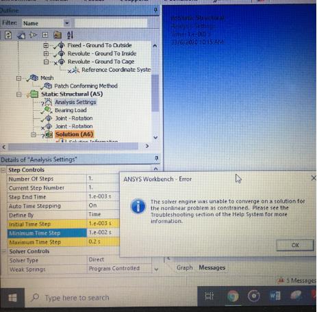

June 23, 2020 at 2:24 am
June 23, 2020 at 1:35 pm
SaiD
Ansys EmployeeHi,
The minimum time step you have defined is 0.01 s and the maximum is 0.2 s. So the Solver can take time steps such that 0.01s
