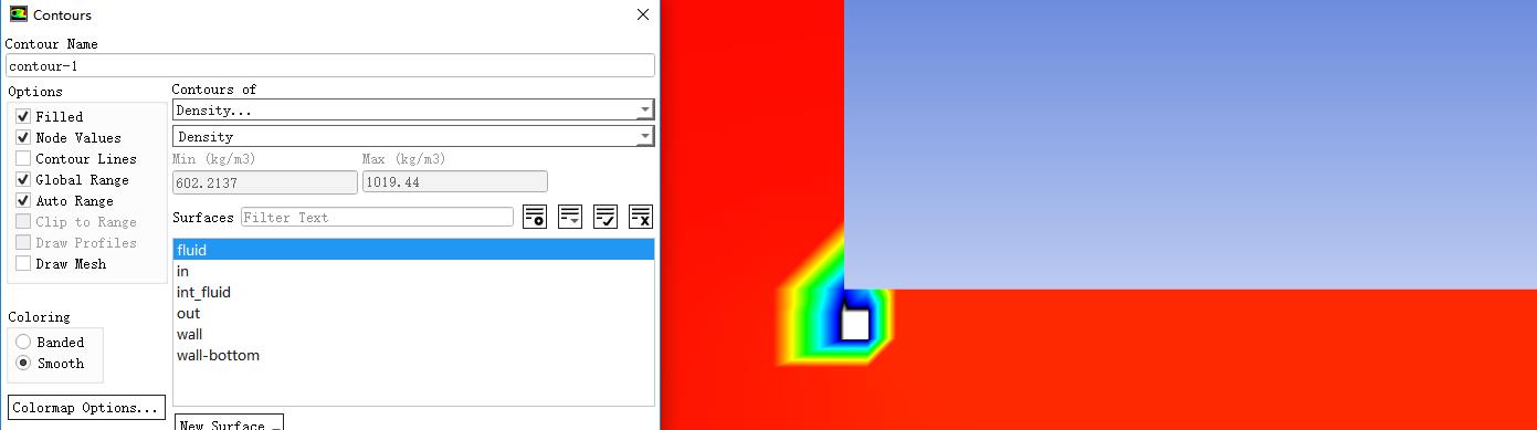

SubscriberI am conducting a simulation of cavitation in a simple geometry. However, i didn't use the cavitation models which had been implemented in Fluent. I am trying to implement a single-phase model (a barotropic models, pressure is only a function of density) into pressure based solver in Fluent by using UDFs. However, when the simulation was run, i got the error information about "Divergence detected in AMG solver".
The simple geometry is meshed with all-quadrilateral element.
I am using a Realizable k-epsilon turbulence model with scalable wall functions. Pressure-inlet of 30MPa and pressure-outlet of 1Mpa are adopt.
Validation of UDFs which is a piecewise function by an excel spreadsheet.
The error is shown as follows:
When i checked the contour of density or pressure, there was a black cavity in the model.

SubscriberActually, the occurance of negative pressure is wrong because the operation pressure is set to 0. Generally, in this case, the cavitation model can prevent pressure from falling below saturation vapor pressure.
In the case of UDF using, a pressure value corresponds to a density value. In this simulation, the error appears as before the pressure falls below the saturation vapor pressure. For example, as the min pressure is 100000 Pa, the calculation diverges and the corresponding density is changed into a black cavity as the graph shown. In this case, the negative pressure is forbidden. And sometimes AMG devergence occurs as the presence of negative pressure.

I tried to fix the pressure-inlet as 50MPa and decrease gradually the pressure-outlet from 40MPa. As the pressure-out is 22MPa, the model can run well. While as the pressure-out is set to 21MPa, the devergence occurs.
Strangely, the Min density is 602 kg/m3, and the corresponding min pressure is 662482Pa. I can't understand this result because the density should be 998kg/m3 under the pressure of 662482Pa. A decrement of 1 MPa induces such big variation.
When i change the pressure-out from 25MPa to 20MPa, there is another error. The min pressure is 754074Pa and the density is 999kg/s. There is also a black cavity in the graph of density contour.

Ansys EmployeeTurn off node values & replot. You're looking at a smoothed result, but the solver will be using the cell values.

SubscriberI don't think it's a replot problem. The calculation diverges, then the graph obtained is wrong.
November 15, 2019 at 2:38 pm
Rob
Ansys EmployeeTurn off node values & replot. You're looking at a smoothed result, but the solver will be using the cell values. This may well give you a different range.
