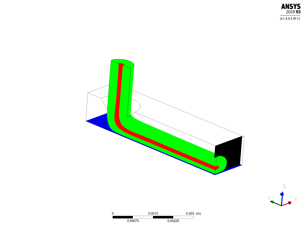

Hope you guys are doing well. As seen in the image below, I have simulated a flow of plastic (green) onto a build plate. There exists a continuous flow of another liquid (red) in the middle of the plastic.

SubscriberHello,nThanks for the replies. Here is a detailed run down with images as to what exactly I am doing and what the resultant output is. nI am using the VOF model with Explicit formulation. The flow is laminar. There are 3 phases. I create three materials: Air, Oil and Plastic with different properties. I go to phases and set air to be the primary and the other two are secondary phases. nSince I only care about the phase interaction between the oil and plastic, I setup surface tension there.nn I used the Non-Iterative Time Advancement with Fractional Step but the solution did not converge. So I changed it to SIMPLE.nNow, I create regions for plastic and oil (Images attached). I Initialize and patch the regions. Now if I set the VF of plastic and oil to be 1, it gives me an error (image attached). Should I just set it to be 0.5 each? n

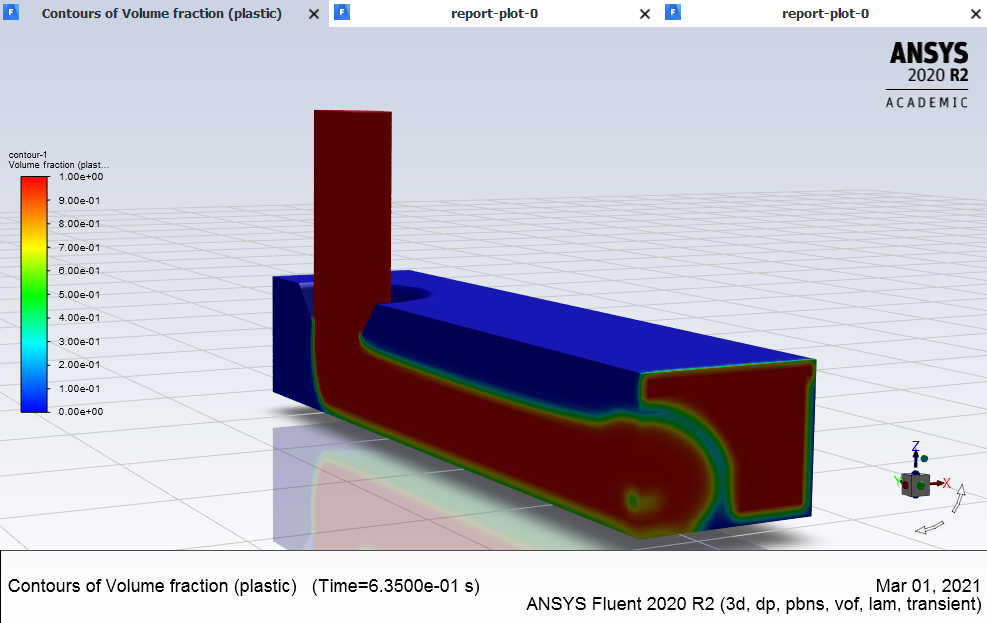

SubscribernI created two different zones so that I could assign the volume fraction of air to that zone, instead of assigning the VF for plastic. I was able to solve the VF error from above.nnNow, the droplet elongates/moves along the channel with the plastic. However, I am still facing some issues. nI am playing around with different time steps. The one attached below has a time step of 0.0005. As you can see from the image there is some plastic present at the outlet. This is incorrect and should not happen. I do not know the reason for this. Also, the results do not converge even after a very long time. And as the oil droplets moves, its volume keeps on decreasing. Is that supposed to happen?n
Even if I let the simulation run for a longer time, there still seems to be some plastic where air is supposed to be. n
nIs there anything else I can change? Do you happen to know what the reason might be?n

Ansys EmployeeCheck the backflow phase setting re the outlet. You won't be the first person to have the wrong phase set. If you're losing mass from the blob it's usually either the mesh being too coarse or the time step is too big: you're not conserving mass sufficiently. nMarch 3, 2021 at 11:48 pmharshabharadwaj1
SubscribernThanks for all the help sir. It was indeed the backflow that was giving me issues with the flow. Since it is a three phase setup, the backflow for both the secondary phases was set to 0.nNow, I changed the backflow for air to be 1. I seem to get good results with this.nI did read up some stuff about the backflow. Either I have to increase the length of the cylinder in the outlet direction or use prevent back flow option. Will it make any difference if I change the Volume Fraction Specification Method?nAlso, I am not specifying operating conditions? Is that vital for a VOF simulation as well? If so, what would be the values?nAnd regarding the mass conservation, I will play around with the mesh size and time step size. nThanks a lot for the help.n
