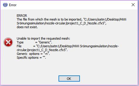

satm11
SubscriberHello I have uploaded a screenshot

Rob
Ansys EmployeeI suspect it's the path. ANSYS really doesn't like non-English characters so try replacing the O-character in Sromungssimulation.
