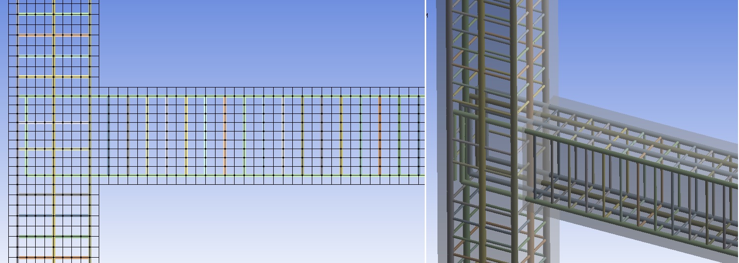

      what i usually do is set the rebars at fixed spacing of the mesh i am going to set, for example i set rebars at 50mm from edge then i use 50mm mesh to have coinciding nodes. I am soon going to try your EREINF commands as soon as i am free, and let yo know if there's any success.
    • gigihmprayogo
      I'm not partitioning the geometry, i'm just design the model in CAD first, so basically I plan the geometry and mesh size there, then i go to the Design Modeler & Mechanical module to make the geometry and mesh size of the model are exactly same from what I made before..It is need extra effort, but that's the only way I can do it. I want to compared with REINF264, but its just not yet working

      firstly select your concrete and rebar bodies and add named selection seperately for "concrete" and "rebars". then add the line "steel_mat_id=matid" in your line bodies. Add the command mentioned below for REINF264 and you can post process it to view the model.
      ADPL for line bodies:
      *get,myarea,SECP,matid,PROP,AREA ! gets the area and  assigns it to myarea
      ET,matid,LINK180 ! define link element
      steel_mat_id=matid
      SECTYPE,matid,LINK ! assign link
      SECDATA,myarea ! assign area
      MPDATA,EX,matid,,2e5
      MPDATA,PRXY,matid,,0.3
      TB,BISO,matid,1,2,
      TBDATA,,400,0

      I hope it works for you. We still have to figure out how to use REINF if there are multiple different sized rebars in the model.
    • gigihmprayogo
      Finally i found the source of error, its because i'm using CPT215 as base element, when i change base element to SOLID185 for example, the snippet works..So if you are modelling concrete using coupled damage-plasticity microplane model with CPT215, set base element with SOLID185 first then use snippet above from @Wenlong, after command line delete mesh200, add another line to change SOLID185 to CPT215

      SECDATA,REBARSD13_MAT_ID,A_D13,MESH         ! Define the section properties
      ! Define Reinforcement Section D19
      SECTYPE,D19_SEC_ID,REINF,DISCRETE           ! Define a discrete reinf section
      SECDATA,REBARSD19_MAT_ID,A_D19,MESH         ! Define the section properties
      ! Define Reinforcement Section D25
      SECTYPE,D25_SEC_ID,REINF,DISCRETE           ! Define a discrete reinf section
      SECDATA,REBARSD25_MAT_ID,A_D25,MESH         ! Define the section properties
      !!!!!!!!!!!!!!!!!!!!!!!!!!!!!!!!!!!!!!!!!!!!!!!!!!!!!!!!!!!!!!!!!!!!!!!!!!!!!!!!!!! End of Section 3 !!!!!!!!!!!!!!!!!!!!!!!!!!!!!!!!!!!!!!!!!!!!!!!!!!!!!!!!!!!!!!!!!!!!!!!!!!!!!!!!!!!!!!!!!!!!!!!!!!!!!!
      !!!!!!!!!!!!!!!!!!!!!!!!!!!!!!!!!!!!!!!!!!!!!!!!!!!!!!!!!!!!!!!!!!!!! Section 4: Assign Element, Material & Section !!!!!!!!!!!!!!!!!!!!!!!!!!!!!!!!!!!!!!!!!!!!!!!!!!!!!!!!!!!!!!!!!!!!!!!!!!!!!!!!!!!!!!!
      ! #1 Assign Concrete Element Type to Temporary Element
      CMSEL,S,CONCRETE,ELEM
      EMODIF,ALL,TYPE,CONCRETE_TEMP_ET_ID
      ! #2.1 Assign Rebars D10 Using REINF264
      CMSEL,S,D10,ELEM
      EMODIF,ALL,TYPE,MESH200_ET_ID       ! Change the element type to Mesh200
      EMODIF,ALL,SECNUM,D10_SEC_ID        ! Change the section to discrete reinf
      ! #2.2 Assign Rebars D13 Using REINF264
      CMSEL,S,D13,ELEM
      EMODIF,ALL,SECNUM,D13_SEC_ID        ! Change the section to discrete reinf
      ! #2.3 Assign Rebars D19 Using REINF264
      CMSEL,S,D19,ELEM
      EMODIF,ALL,SECNUM,D19_SEC_ID        ! Change the section to discrete reinf
      ! #2.4 Assign Rebars D25 Using REINF264
      CMSEL,S,D25,ELEM
      EMODIF,ALL,SECNUM,D25_SEC_ID        ! Change the section to discrete reinf
      ! Generate Reinforcing Element
      CMSEL,S,CONCRETE,ELEM               ! Select Concrete Element
      CMSEL,A,REBARS,ELEM                 ! Add All Rebar Element to Selection
      EREINF                              ! Generate reinforcement elements
      ESEL,S,ENAME,,MESH200               ! Select the Mesh200 elements
      EDELE,ALL                           ! Delete the Mesh200 elements
      ! Change Concrete from Temporary Element to CPT215
      EMODIF,ALL,TYPE,CONCRETE_ET_ID
      EMODIF,ALL,MAT,CONCRETE_MAT_ID
      ! #3 Steel
      CMSEL,S,STEEL,ELEM
      EMODIF,ALL,TYPE,STEEL_ET_ID
      EMODIF,ALL,MAT,STEEL_MAT_ID
      !!!!!!!!!!!!!!!!!!!!!!!!!!!!!!!!!!!!!!!!!!!!!!!!!!!!!!!!!!!!!!!!!!!!!!!!!!!!!!!!!!! End of Section 4 !!!!!!!!!!!!!!!!!!!!!!!!!!!!!!!!!!!!!!!!!!!!!!!!!!!!!!!!!!!!!!!!!!!!!!!!!!!!!!!!!!!!!!!!!!!!!!!!!!!!!
      ALLSEL,ALL
      /SOLU
