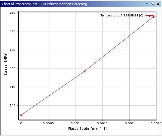

I did simple analysis of c. beam. I used nonlinear material, PA GF15. I converted engineering stress and strain to true.
In the results I did not get corresponding curve of stress strain.
red - Eng. stress-strain,
black - True stress-strain,
blue - the result stress-total strain.
I wanted to determine max. Force which should be occur in max. stress (in the above pic. it is about 120MPa.), but the result of stress and strain behave as linear not as nonlinear, which is needed.
I sent the data sheet of material and the archive file of the analysis.
Whether I have determined Young module correct.

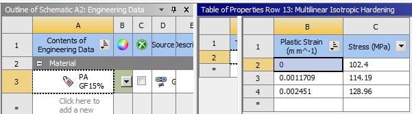

SubscriberHi Adisa,
MULTILINEAR PLASTICITY
A single element in a pure tensile test is a good way to validate a plasticity material model. A pure tensile stress is developed if three displacement supports, one for each of three orthogonal faces, are provided. Then a force on the end creates a tensile stress. The cross-sectional area of your beam is 75 sq. mm so a force of 10,000 N creates a stress of 132 MPa.
Look at your Multilinear Plasticity Model. It only goes up to a strain of 0.002451 and a stress of 129 MPa which means the solver can't go past that point.
Look at the change in slope at 114 MPa, there is almost no change in slope at that point and the change is hardening, not softening, which is what I would expect to see.
When I tried to solve my 4 element model, it stopped with an error at t=0.96 when it got to the end of this table.
Below is a revised table that goes to higher values of stress and strain and there is a significant change in slope at 129 MPa.
Now the solver will get to the load requested. Here is the chart you created of equivalent stress vs total strain. The change in slope at the yield point of 102 MPa is visible, as is the change in slope at 129 MPa at the last point you defined. The last few points are on the new segment I added at the end.
I hope this answers some questions you had about the response of your material model. If you have other questions, please ask away.
