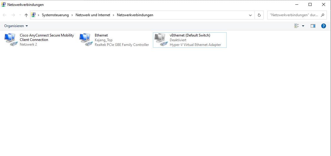

Hallo everyone, I faced this same problem for past two weeks and finally solved it.
My Fluent keep pointing the error " Fluent application failed to start".
and in the Fluent log box says "Unable to connect to external socket: Error during socket creation Opening output fil".
Based on this I assumed there is a connection failure between a Host and client.
My set Up is a Client Side on Windows 10 with a VPN (Cisco) where i am receiving the license for Anysy from my university.
I did everything as mentioned turning off firewall, reinstalling as admin, reconfiguring my VPn. but neither was working.
Solution
In the end , i traced back the problem to my Hyper-V Virtual Adapter Ethernet. If you are a Android Studio developer most probably you have this one too.
Deactiavte it as i showed in this image. After that restart the pc and all error will not show again.
