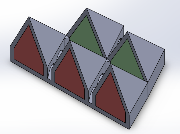

February 21, 2021 at 6:40 am
Lakshay
SubscriberActually I also tried going by a different approach of including the fog domain into the cad and them applying material to it, but still no success. In the image below, the grey part is metallic structure and the red triangles and green triangles and completely filled in the structure (air front and air rear respectively). I selected the front surface of these red and green air parts as inlet and the rear smaller visible part as outlet, but in the fluent there is no OUTLET showing in boundary conditions. You can see the OUTLET that I have selected in the below image.nn

February 22, 2021 at 12:11 pm
Rob
Ansys EmployeeCan you post an image of a mesh cut plane in Meshing so we can see where the mesh is? n -

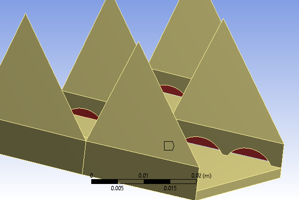

February 22, 2021 at 3:01 pm
February 22, 2021 at 4:56 pm
Rob
Ansys EmployeeOK, part of the problem is there is no outside in your domain. You have the metal part and cavity only. The mesh is also far too coarse to resolve the flow field, and I don't think the volumes are connected so there are no faces to assign as the outlet on the cavity. nGo through the tutorials that come with the software, as that will help get you going with the basics. From there you'll see what you need to do for the above case and will know what questions to ask. n
