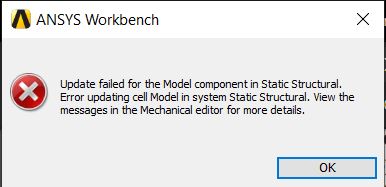

SubscriberI replaced the solid body with surfaces as you instructed:
I then tried meshing this with adaptive setting and without changing the other default settings to start with.
But i encountered an error and the meshing stopped:
I used a smaller 9X9 model this time as compared to the 25x25 model previously.

SubscriberDelete all mesh controls. In the Mesh Details window, set the Element Size to 0.5 mm. Turn off Automatic Defeature. Does it mesh without error?

SubscriberIt does mesh for the 9X9 model after turning off automatic defeature. As it meshed for this case I also tried a similar process for 25x25 model. But when try I replacing the 25x25 model with surfaces using the mid-surface tool, Spaceclaim keeps processing for more than 1.5 hours and still doesn't convert the model to surfaces. Spaceclaim becomes unresponsive after this.
update: Meshing for the 9X9 case finishes but i receive multiple messages of the quad mesher failing.

Also I haven't been able to make an error free mesh yet. As i mentioned previously, the mesh for the 9X9 model does form after conversion to shell elements but i receive multiple warnings of the quad mesher failing. And Spaceclaim becomes unresponsive trying to midsurface the 25X25 model.
