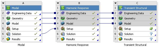

I changed your Geometry and sliced it up to make a vertex at the Evaluation Point. I changed the BCs to be on geometry instead of nodes. I don't have the sall BC quite the same, you can make 4 planes and 4 slices to make faces where you want to bond to a wall.
I changed your model to be a Modal Superposition method to calculate the Harmonic Response. That is done by linking the Modal Solution cell to the Harmonic Response Setup cell.
That required that I turned off the Damped solver in Modal.

Another analysis that can be added to this model is a Transient Structural.
This is where the force-time plot you showed in the attachment can be applied to the vertex in the center.
Reply with the data from the graph in a text file or spreadhsheet if you want me to help with that.

SubscriberYes, you can use just a Transient Structural with no other systems and it will solve the response to the force-time history applied to the center point.
