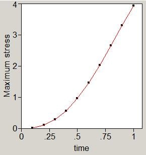

SubscriberHere is the data from your first tab plotted.
This doesn't look like it is the output from a Transient simulation. This looks like the nonlinear convergence plot of a Static Structural analysis.
I was expecting thousands of rows of data sampled at each millisecond for several seconds.
If you want to attach your ANSYS Project Archive, I will take a look at your model.
