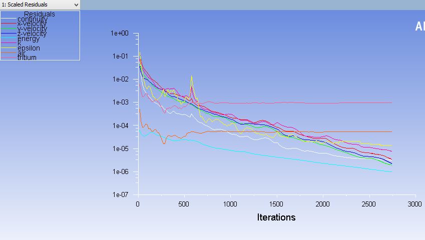

SubscriberHello! and ! Now I do not understand one thing! It is velocity result! I applied the same mass flow inlet 2 and mass flow outlet 2, but the results of velocity at inlet 2 and outlet 2 are totally different. I applied mass flow inlet 2=mass flow outlet 2= 1.51kg/s, and according to my calculation the results of velocity at inlet 2 and outlet 2= 1.64 m/s, but the velocity vector shown in Fluent appeared that velocity at inlet 2=1.64 m/s to 1.72 m/s (this one is quite correct), but the at the outlet 2 , the velocity is only 0.094m/s. According to the same amount of mass flow rate that I applied at the inlet 2 and outlet 2, so it is correct or not that we should get the same amount of velocity at the inlet 2 and outlet 2? Or because of the flow behavior that make the velocity at the outlet 2 become too small? I also realized that the velocity at the outlet 2 is not normal to the surface of the outlet2 at all, maybe this is the reason, but I am still not sure! You can see the boundary of inlet 2 and outlet 2 as the following figures:nAnd here is the results of velocity:n
Thank you again for your helps and great advices for me!n
February 22, 2021 at 11:31 amRob
Ansys EmployeeYou shouldn't have mass in and mass out unless there is a way for the solver to add/remove material to balance the boundaries. How does the mass balance in the domain look, and how good is the convergence? nFebruary 22, 2021 at 12:22 pmSEANGHAI
SubscriberThank again for your reply! Sir! Honestly, I do not know how to check the mass balance, how can I check it? Is it the contour of mass imbalance? I never check about it! Can you guide me something? And the solution is converged at 2730 iterations! I saw a problem in the velocity vector, the vectors at the inlet 2 are too big because of the amount of mass flow rate is big! You can see the velocity vector as the following:nI am looking forward for your help!nn
February 22, 2021 at 1:54 pmRob
Ansys EmployeeLook in Results - Fluxes. Please go through the tutorials as they cover most of the basics. nFebruary 22, 2021 at 4:13 pmSEANGHAI
