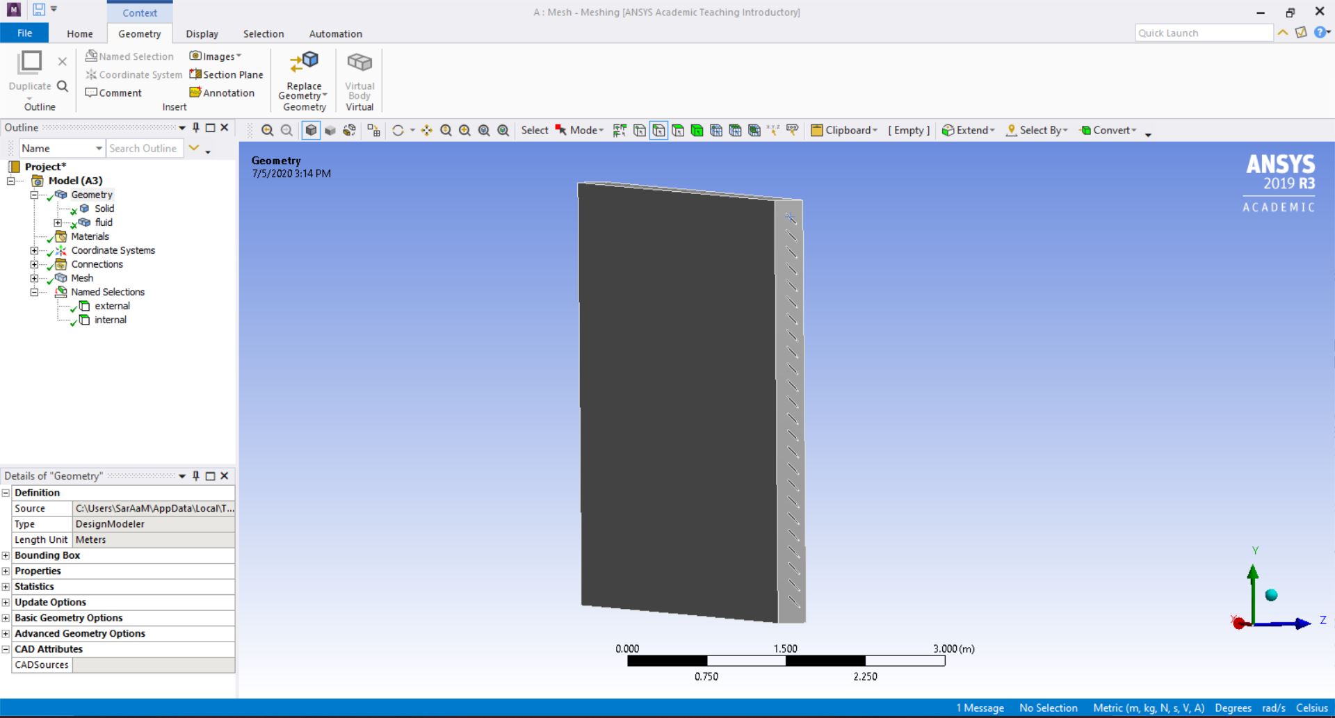

Ansys EmployeeYou'll need to create a solid volume and then split out the aluminium plate.

SubscriberHi rwoolhou I followed your suggestion but it's have a promble.
hollow of aluminium it empty and i used fill function to create a fluid domain such as first figure.
In the next step i have to go mesh internal glass ,external glass, and fluid domain (i think a solid is domain fluid and i not sure is correct) and i can't mesh my aluminium blind.

Ansys EmployeeBecause they're thin surfaces. Have a look through the tutorials, and review the section(s) on baffles.
