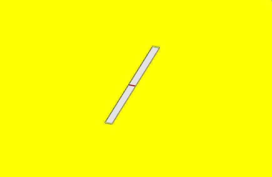

SubscriberHi, I'm trying to simulate the reception characteristics of a slot antenna on a substrate using HFSS.
I created a 3D model of a slot antenna surrounded by a boundary box. Then I put a lumped port at the center of the slot, and assigned the top surface to wave port as an incident wave.
Now I want to calculate the power received by the lumped port under conjugate matching condition, but how can I obtain the received power?
I'm new to HFSS so I would appreciate any comments. Thank you in advance.

Ansys EmployeeHello,
From your description about the scenario, it seems like giving a required input power as a 'System Power' through Excitation source settings and taking the S-parameters will help.
For more details please refer the help document .
