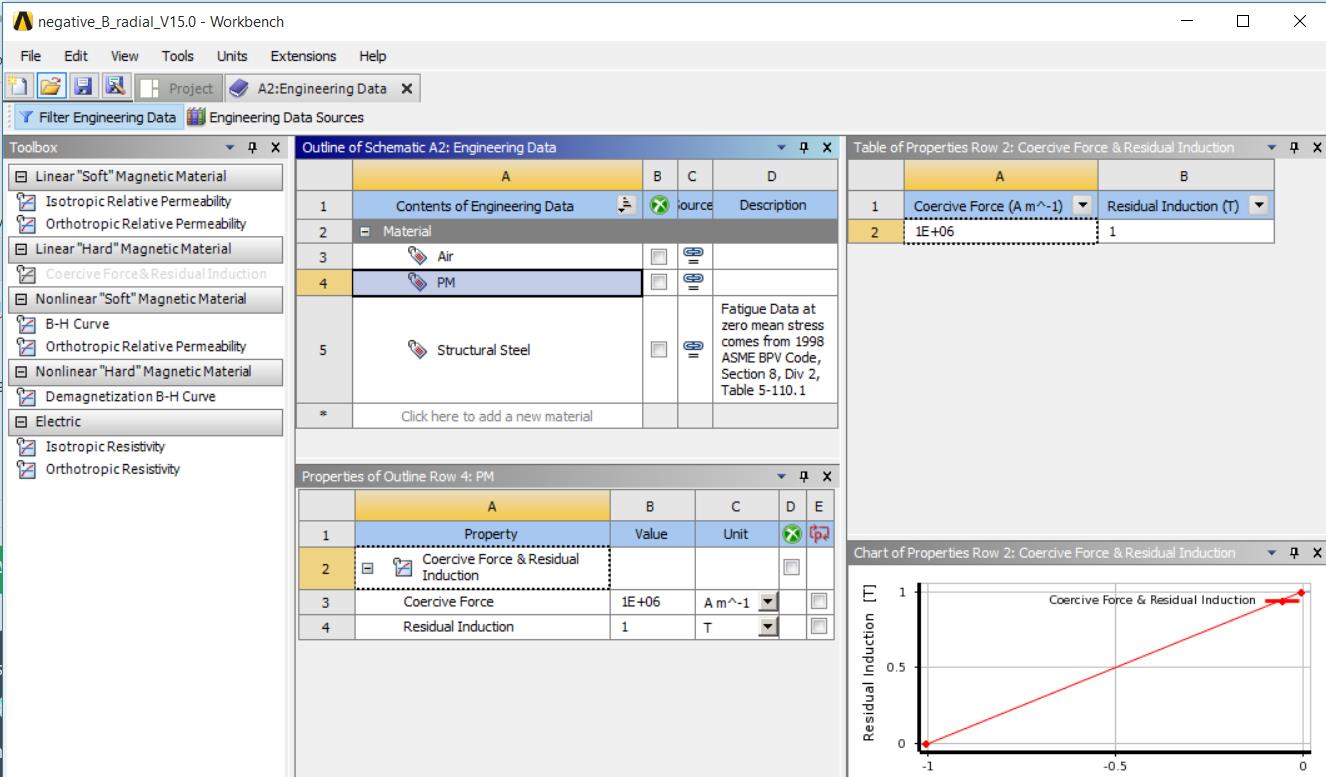

SubscriberIn a magnetostatic analysis, I am trying to simulate the magnetic fields of a ring magnet.
I want the magnetic polarization is a negative x polarization is in the negative radial direction of a cylindrical coordinate system.
I created a cylindrical coordinate system.
I used the Material Polarization setting in the Details view to orient a polarization axis toward a negative x .
However, when I analyzed the magnetic field, the direction of the magnetic field was in the positive radial direction.
What should I do ?

Note: In a magnetostatic analysis, you can orient a polarization axis for a Linear or Nonlinear Hard material in either the positive or negative x direction with respect to a local or global coordinate system. Use the Material Polarization setting in the Details view for each body to establish this direction. The Material Polarization setting appears only if a hard material property is defined for the body. For a cylindrical coordinate system, a positive x polarization is in the positive radial direction, and a negative x polarization is in the negative radial direction.
I set the model according to this message, however a negative x polarization did not become in the negative radial direction.
Regards

Hi Jojo,
As an example, I created a hypothetical linear PM material in Engineering Data:
I assigned the PM material and a cylindrical coordinate system to a ring with polarization in the x-direction:
I set a flux parallel condition on the exterior boundary of the spherical enclosure:
and get flux density pointing radially inward:
Incidentally, we suggest that you set the following variable using Tools > Variable manager to use the newer SOLID236 electromagnetic solid instead of the older and now undocumented SOLID117:
I hope this helps you!
