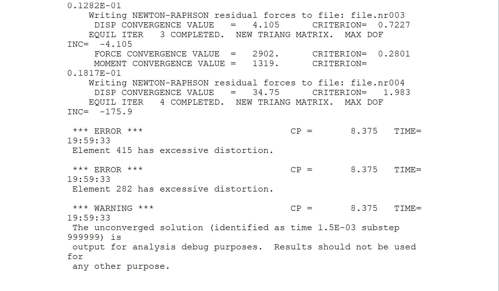

      2. I am currently meet some problems on convergence issue, when I was doing the transient structural with my flexible PCB, if I turn on the large deflection, it will have some errors, I do use small time steps, but still have no idea why it will happen. while if I turn the large deflection off, there will be no errors and I am good to get the result, do you have and suggestion? I also attached the solver output file and the workbench file.

      2. You can see that the solver was heading for convergence on that last step, it it had just not quit after 26 iterations. That is where you introduce a Command item into the Transient Structural branch (not the Solution branch). Click the Insert Commands button,
      Then type the command: NEQIT,60
      This tells the solver to keep iterating for 60 attempts instead of the default 26.

      1. every time when I turn on the large deflection, there will come the warning as I posted following, will it have a big influence on my final results?
      2. Thanks for telling me that I could also change the default iteration from 26 to 60. but why I did not find out that It is the issue of inadequate iterations from the solver.output file? but if I decrease the minimum time step, I find it out that there will be no convergence issue, does them means the same thing?

      2. Even with linear materials, there is a false stress as explained in the article above, due to large rotations in the solution that are not being properly computed. When Large Deflection is Off, the small angle assumption is used to make the computation faster.  When you turn on Large Deflection, large rotations are handled properly, which takes more time to compute but then a large rotation of a sheet will not generate a false stress.  In a model like yours or the skin on a drum head, even though the rotations may remain small, the deformation in the Z direction when solved with Large Deformation turned on adds tension to the drum, which reduces how far the drum head deflects under a given load.  If you turn off Large Deformation, then no tension is added and the drum head deflects much more than happens in reality. That is the effect I made the plot for in my previous post.

    • xiaofuli
      This is the error I got from the solve.out file
      The element has excessive distortion, is the reason that the mesh is not fine enough, or the element type is wrong, or the time step is not small enough? could you please give me some suggestion? since I meet this kind of problems more than one time. it is archive file I sent it to you last time, you could also take a look at it. Thanks
      Best Regards
      xiaofu
    • peteroznewman
      Sine Sweep on Shaker Table: Is it constant amplitude or constant acceleration?
      If the constant displacement is 1.4 mm, then the acceleration is 36 G at 80 Hz, while it is 225 G at 200 Hz . That is a lot more reasonable than 3000 G.
      If the constant acceleration is 36 G acceleration, then the displacement amplitude is 1.4 mm at 80 Hz and reduces to 0.2 mm at 200 Hz.
      Find out what the shaker table settings were for the experiment. I think you will find is it a constant G force input with the start and end frequency. What three values were input into the shaker controller?
      If the shaker input was a constant G force input, then use an acceleration input with fixed supports in the model.
      If you find the shaker input was a constant displacement of 1.4 mm, then use a displacement input with fixed rotation in the model.
      2. The exceedingly high G acceleration caused the solver to fail to converge, which may be because of the plasticity in the model. The high acceleration causes a high stress that stretched an element so far out of shape that it could no longer compute stress and strain.  If you delete the Multilinear plasticity and rerun the solver, you might find it gets further in time than it did before, but as I said, the final value of 3000 G is ridiculous and the solver may not converge later in time even with a linear material.
      The solver doesn't stop when the nonlinear material Total Strain exceeds the material property of Elongation at Break. It just keeps stretching the material. You have to plot the Total Strain and see if the maximum value has exceeded Elongation in order to predict failure.  This is just like a linear elastic material, the solver will continue to run to values of stress far exceeding the Ultimate Strength. It is up to you to plot the von Mises equivalent stress and compare it with the Ultimate Strength to see if the part is predicted to fail.
      3. I don't know what you saw in the video that was 15 mm. If the shaker was set to 1.4 mm, that is what is important.
