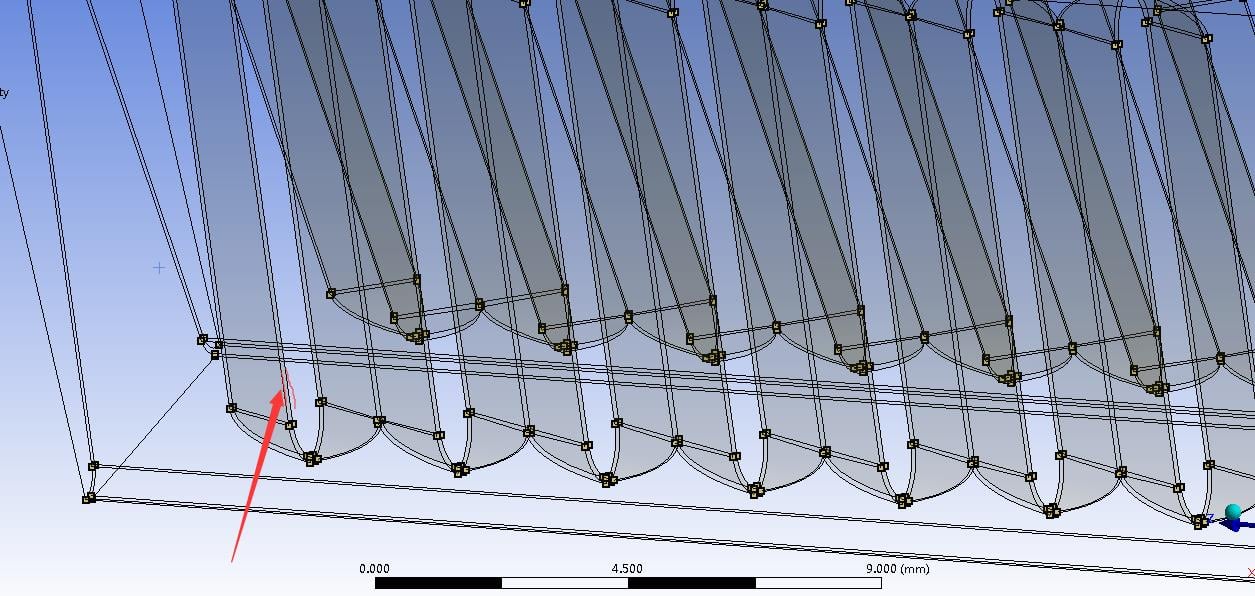

SubscriberHI, recently I am generating a mesh for a louvered fin geometry with ANSYS MESHING, the thickness of the fin is 0.1mm, and there is a boundary layer of ten layers on the fin surface? However, when i finished the meshing, i found the minimum orthgonal quality was as low as 0.02, obviously it cannot be processed in FLUENT. And various trials have been done by me to improve the quality, but they all did not work. So, can someone do me some suggestions to improve it?

Ansys EmployeeThe starting point for this is to understand where and why you have poor quality cells: otherwise I could just reel off a long list of things that will work but not necessarily be causing you a problem.
Use the quality graph and pick the lowest 2-3 columns to highlight the poor cells. Identify why they're bad, and then see what can be done to change this. Post a few screen shots too.

Rob
Ansys EmployeeIt's hard to tell from the images: do you have a thin face at the end of the louvres? What is it for?

Rob
Ansys EmployeeDepending on the application you may be able to use a thin wall in Fluent: we don't need to model metal thicknesses in most applications. This avoids the small face at the end of the unit.

Rob
Ansys EmployeeIf it's for thermal properties read up on shell conduction. Otherwise you'll need to resolve the plate thickness which will increase the cell count.

Rob
Ansys EmployeeThe problem is caused by the transition from the inflation layer to the first cell. Mesh without the inflation and compare the effects.

Rob
Ansys EmployeeThen you need to do something to avoid the inflation terminating and giving poor pyramid caps. When you say you need to consider the plate thickness why is that?
