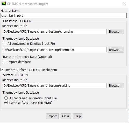

I am using the species module in ANSYS Fluent and tried to import CHEMKIN mechanism into my module. I added the mechanism according to the steps described in User Manual. However, the import failed and I got an error message (see below).
The screenshot of species solver and the CHEMKIN mechanism import section are attached as below:
Can anyone tell me how to solve this issue please? Many thanks.

Ansys EmployeeHard to say. What do the files which are created on reading tell?
Is it an encrypted mechanism? You can attach the data so that non ANSYS staff can check. -

The CHEMKIN mechanism I used was from the following website: https://www.detchem.com/mechanism It's about the detailed surface chemistry of C3H6/CO oxidation and NO reduction on Pt/Rh based catalyst. There is no gas-phase reaction.

Ansys EmployeeIf there is no gas phase reactions how can you explain the screenshot you posted? We need a gas phase mechanism to full the import? What did you import there? Have you looked into the files I was mentioning? Can you just attach what you trying to add?

1&2. The mechanism file for gas-phase is attached as below. I only defined the elements and species in this file in order to complete the import.
3. I am not quite sure the files that you were mentioning refers to which file.
4. I didn't find out where can I attach files in this discussion and I can only insert the screenshot. The screenshots of the surface mechanism I used are attached as below. If possible, would you please tell me how to attach a file in the discussion? Many thanks.

Ansys EmployeeMehanism and Thermo files were containing mistakes. After correction both files can be read properly in to 2019R2.
