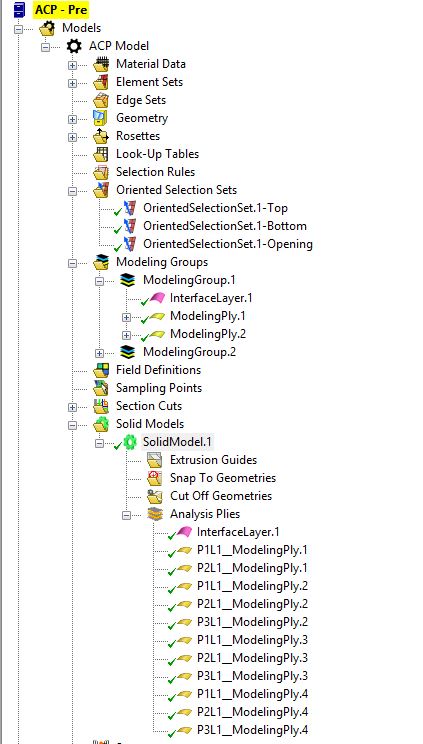

SubscriberI tried to analyze contact debonding using CZM. I modelled a composite material with an interface layer in ACP module. The solid I created in the ACP module has the interface layer. However, when I Import it to the Mechanical for static analysis, the interface layer keeps missing from the imported file. The warning "not all named selections were successfully written" keeps on popping up.

The interface layer is imported to "Fracture" --> "Interface delamination". The warning about the name selection is not related to this.
