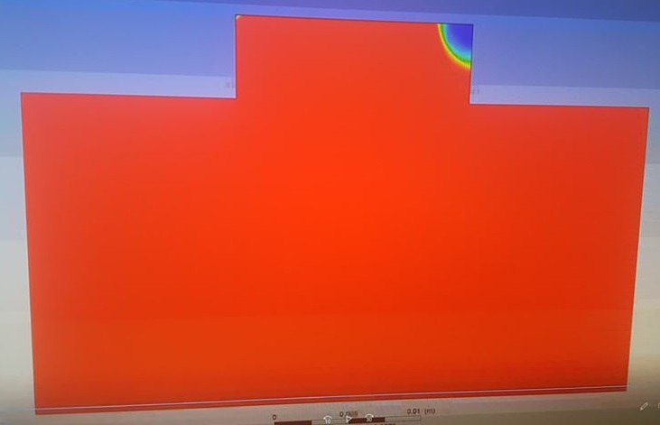

I am working on two-phase flow.
I am facing the problem of incomplete filling. here I attached some screenshots of the results. the length of the channel is 40mm and the height is 20mm and 50 micrometers respectively. when I reduced height I get an incomplete filling. can you please guide why it is happening and what should I do for complete filling. looking for your suggestions. thanks in advance.

SubscriberDear Amine i post the sketch of the problem above
I used vof model with laminar flow also
My question is if i reduced the height i am getting incompelet filling
First one height and length is 20mm and 40 mm
Second case height is 50 micrometer and length is 40 mm.
For the second case i am getting incompelet filling.

here I described the case-1 and case-2. with these settings in fluent for both cases. I also attached the archive file if you need any further detail you may check it.
now I show you the results of case 1 and case-2 respective
case- 1 shows full-filling but In the second case with the same settings, it does not fill the air area. as shown here.
I also increase the no of iteration per time step and also use different models like the k-epsilon model with standard wall functions and scalable wall functions. but it does not work for me. hope this time you get good screenshots.
I need your suggestion to fix this issue and show complete filling.

Ansys EmployeeBe a bit polite and cooperative. I am helping here on voluntary basis. I assuming you are using high quality quadrilateral grid for this simple geometry.
Now (how I would debug this or model filling):
1/I recommend to make phase-1 air and phase-2 liquid
2/By doing 1/ you will need to adjust the boundary conditions and the way you patch the case
3/Why 1/ because it is better to make the compressible phase the primary phase. Also use ideal gas for air. In order to avoid solving energy equation one needs to turn it off (turned on automatically after you select ideal gas for air). We want just to have baratropic air
Now run this system
Another point is to turn the system without adhesion or surface tension effects: you asked for help so please help us to help you otherwise that would be my last comment wherever I see messages from you.

Ansys EmployeeThe idea of ignoring surface tension is just for debugging purpose. Your grid is poor. Make quads and increase the number of cells in the height to at least 10 or more. -

Looking at the set up it's fine. Your problem is the mesh. With VOF you resolve the interface between the two phases. Insufficient mesh means you will fail to do this, and (probably) lose mass which is why you don't consistently see the fluid trapped in the pocket (assuming it's the lighter phase.
To add, you may need a lot more hex mesh than you think: aim for absolute minimum 6-10 cells in the depth of the pocket and aspect ratio of 1. Time step may also be critical.
