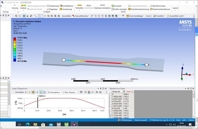

The imported heat density from Maxwell to steady state thermal is shown in picture 1.
It should be that the calorific value on both sides of the board is small, and there are two maximum values in the middle part, but the calorific value in the middle part is less than the two maximum worth points,in picture 2
The distribution should be the almost same as the imported thermal density distribution curve, as shown in picture 3
but the actual result of the steady-state thermal simulation is that the temperature in the middle of the board has not decreased. As
shown in Picture 4
what wrong operation of the steady-state thermal module will cause this this results of it?

Even though there is a heat flux difference between the center and the location where you are seeing the maximum, since you are looking at a steady-state temperature profile, it seems to me that you could be getting the correct answer along the line you are plotting. This could be because the difference in the heat flux is small between the location where you are seeing the maximum value and the center of your board.
One way you could verify - If you run a transient simulation, you might see a temperature plot similar to your hand-sketch (especially in the beginning). If you run this transient simulation longer, you should see the same temperature plot that your steady state model is currently showing.
I hope this helps.

SubscriberIn the steady-state thermal module, the result is that the workpiece is heated to about 900 celsius. I then went to the transient thermal module to analyze and found that after 900 celsius, the workpiece still heats up. Where does the problem cause this?

The setting conditions of the steady-state heat and the transient heat are the same. The transient heat is set for 1000 seconds. Check the temperature curve. The transient heat is simulated to about 600 seconds. The workpiece temperature almost reaches the temperature curve of the steady-state heat. Logically, the simulation should be in It stops at about 600 seconds, but the fact is that the temperature of the workpiece keeps rising to 1100 celsius from 600 to 100 seconds. What problem is causing this error

SubscriberSorry, this picture is 1100 degrees Celsius I used to draw the current of 70A
When I do the transient thermal simulation, I use a current of 65A, so the steady-state temperature curve is about 900 degrees Celsius
Transient simulation for 1000 seconds, but 600 seconds has been 900 degrees Celsius, but 600-1000 seconds, the temperature will continue to rise, reaching 1000 degrees Celsius in 1000 seconds. I don't understand, why is it that the steady-state temperature is exceeded and the simulation will continue for a long time after 600 seconds, where is the problem caused?

I just checked out the problem. My convection heat transfer coefficient was accidentally entered incorrectly. The heat transfer coefficient is different from that in steady-state heat, so this problem
The problem has been solved, and as you said, in the transient heat, the initial curve is the same as I imagined. After 20 seconds, the temperature curve is similar to the steady state thermal curve.
