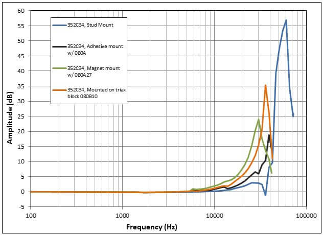

SubscriberYou didn't answer the question about the direction of the hammer strike. Building on the comment by sk_cheah, the natural frequencies in the rod are probably much higher in the axial direction than the bending direction. Also, the flexibility of the accelerometer mount could be higher for axial vibrations because of the tipping moment on the accelerometer compared with bending vibrations of the rod where the accelerometer mount is seeing axial forces in its connection to the rod.
The rod mounted to a magnetic mount has its own flexibility, especially in bending modes. You may get much better correlation between measurement and model if you lay the rod on a very soft pillow or a pair of foam wedges and hit it in the center to excite a bending mode. In the Modal analysis, have no support and ignore the first six zero frequency modes.
