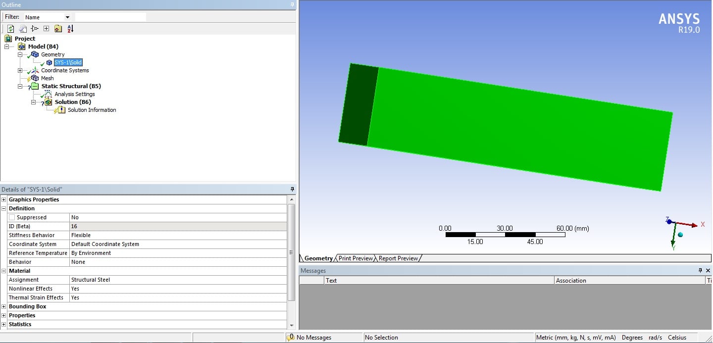

      I tried importing the text file in the ANSYS Design Modeler (DM) but have some issues, something I am doing wrong here needs your guidance.
      (1). After creating the beam in DM, goto Concept > 3D Curve > Select 'from coordinates file' in the definition and then select the text file. I followed till here to get the image which I have attached. Two issues here,
      (1-a) Please confirm is it the correct way of importing the text file geometry in DM?
      (1-b) After importing the axes of the beam and the imported geometry seems to be not the same. The imported geometry should lay inside the beam/solid. As Peteroznewman has shown in his posts. I am missing something here please correct me.
      (1-c) After following up to the step (1) mentioned above, when I click Generate I get an error saying,
      Error: Reached the maximum number of curves allowed for the curve feature
      Context: Curve Feature Curve2
      File: C:.......fibers.txt
      Line: 2000
      Apart from the above issues. Is it possible to generate an interface around each fiber while generating the randomly distributed fibers? Later, I may define the interface parameters like interface thickness, bonding energy, frictional bond etc.
    • peteroznewman
      Jack,
       (1a) Yes, this is correct.
      (1b) When you import, you select a Base Plane. You must select the XY Plane if you want the coordinates in your file to be in the global coordinate system.  Perhaps you had a face or another plane selected when you issued the 3D Curve command.
      (1c) The limit for bringing in curves through DesignModeler is 2000 curves. However, you can break your file into multiple files to stay under the limit and import each file individually. SpaceClaim has no limit.
      I don't know about generating an interface around each fiber.
    • jacks3215
      Peteroznewman, Thank you for your reply.
      Could you please explain how did you import the text file geometry in the Ansys SpaceClaim?
      I have designed a beam in the Ansys SpaceClaim but can not find a way to import the text geometry in to the beam.
    • peteroznewman
      Go to the Assembly Tab, click on the File icon on the ribbon (not File on the top menu bar). Pick the text file generated by the matlab code I provided above.
      That will bring all the curves into the current open SpaceClaim document.
    • jacks3215
      Got some of the issues, kindly guide me on the following,
      (1) I tried using the Matlab files (both SpaceClaim (SC) version and the other one) but for both, I am getting the following error,
      Error using  ./
      Matrix dimensions must agree.
      Error in spaceclaim_random_fiber_generator (line 34)
      rne = lf*rne./delta;
      Whether or not I change the number of fibers, I still get the same error.
      (2) I am using Ansys version 19 and I was unable to open your attached beam model in SC, because of the difference in version.
      (3) I created the beam in SC but when I import the geometry (your attached txt file) in the SC, I ended up with the difference in axes orientation problem as shown in the attached image. How can I put the imported geometry and the beam on the same axes?

    • jacks3215
      @Peter, Thank you for your reply. In continuation of your last reply, I would like to add the following,
      (1). I ran the code in Matlab 2016a but it did not work. I do not have much knowledge of Matlab codings if you may modify the *.m file to use loop as you have suggested in your reply. However, it is working fine in matlab 2017a. I have checked it.
      (3) I modified the box dimensions but got some issues as follows,
      (a) Some part of the imported geometry is laying outside the box (form right, top and bottom) as shown in the attached image. I wonder it might affect the simulation outcome. Could we just bound the imported geometry to lay inside the box in SC or modify the *.m file to do so?
      (b) I tried using the geometry in Mechanical, but the mechanical is only showing the beam or the box, not the imported geometry. After importing the geometry in SC (as shown in the previous image) I saved the geometry file (*.scdoc). Then dragged Static Structural in WB and imported that geometry file and opened the Mechanical. I ended up with the image of beam only. Even the wireframe is showing nothing inside the beam. Maybe I am doing something wrong or our geometry has some issue for Mechanical to load.
    • peteroznewman
      Jack,
      (1) I ran the code in 2016b and it runs.  There must have been a bug in matlab 2016a. Comment out the line that doesn't work and use a for loop shown below (I had to use an image since this site converts some characters into a smiley face   automatically).
      I don't want to install 2016a to test it, so you will have to tell me if that runs, or you can upgrade to matlab 2016b or 2017a. Don't forget to manually paste in the two header lines at the top of the text file.
      3d=true
      polyline=true
      (3a) Make the matlab Box dimensions smaller, instead of:
      % Box dimensions
      bx = 40;
      by = 40;
      bz = 160;
      use Box dimensions that are 12 mm smaller for fibers that are 12 mm long.
      % Box dimensions
      bx = 28;
      by = 28;
      bz = 148;
      Note that the fibers generated go up to 6 mm beyond the box dimension on all sides. If you don't want any fiber outside the SC box, you must draw your box in SC with an origin of (-6,-6,-6). Alternatively, you could add 6 to the x,y,z coordinates of the start and end points in matlab before writing out the text file, then the fibers would extend up to 12 mm beyond the x,y,z box dimensions in the positive direction and no fiber would have negative coordinates.
      (3b) Import created Curves. In SC, you have to generate Beams from Curves. Click on the Prepare tab, and define a cross-section for the beam by clicking on the Profiles pulldown and select Circle.  You will later edit the Circle to type in the diameter you want, but that is a whole new discussion.
      You can see the Create Button is now active and a Beam Profiles folder is under the list of Curves. Click on the first curve in the Structure, and shift click on the last curve in the Structure, then click the Create button.
      All the curves become Beams and the Curves are removed.
