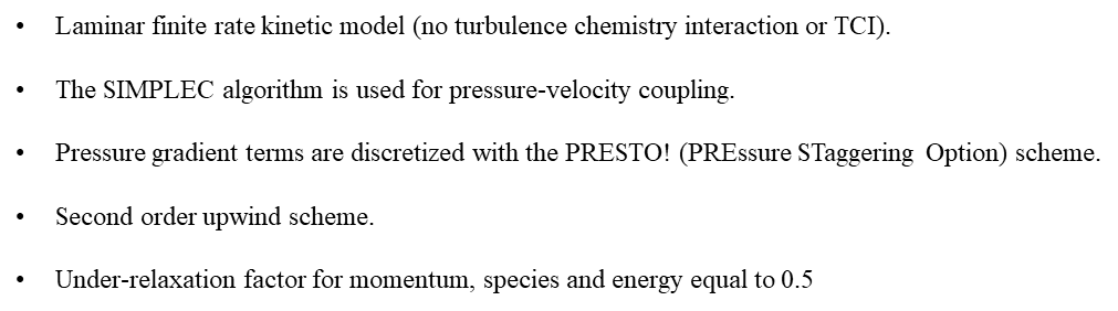

SubscriberHi,nThe paper which I am using for my model validation is simulated in self developed CFD code. The solution methodology for the same is given as:nIn FLUENT, all these methods are not available, so I am using following solution scheme:n
Please help me in this if I am doing it in right direction. Does this variation will affect the results when compared to the paper.n(P.S. PRESTO is used due to porous catalytic bed)nAnshuln
