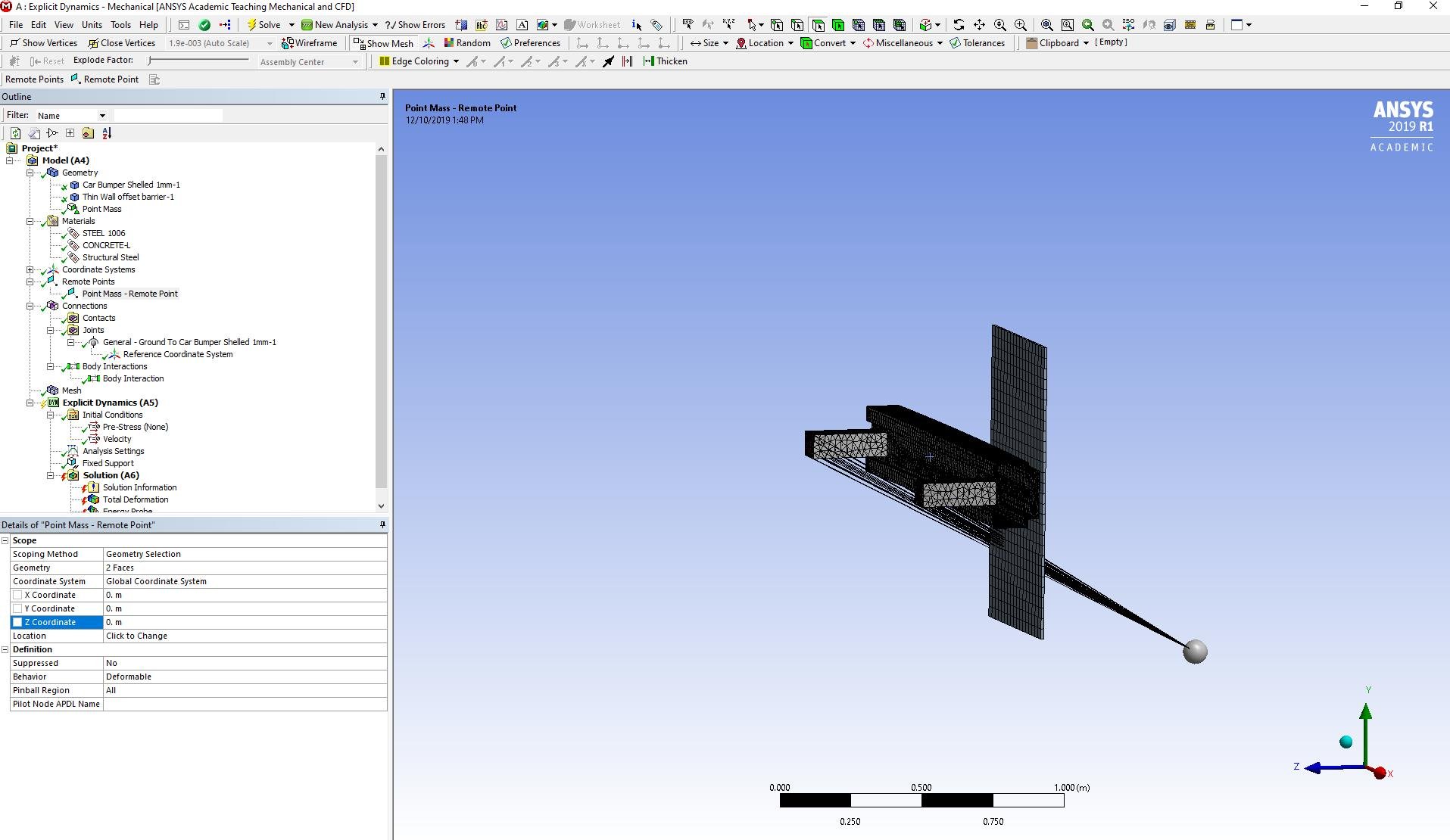

I am trying out an offset barrier test, which involves a car bumper against a barrier of 40% length of the bumper. However it seems that upon crashing the bumper would rotate. Since only the right side was blocked by the barrier, the bumper would pivot at the end of the barrier and the left side will rotate towards the barrier. Is there a way to prevent this from happening and constraint the movement of the bumper to move within an axis? Thank you for your help!

SubscriberYou can add a joint that constrains a remote point to prevent the rotation. You could promote the point mass to a remote point, then reuse that remote point in a joint, Body-Ground. If you select a General joint, you can choose which DOF to set to 0. You might also more the remote point further back since the CoM of the car is not so close to the bumper.

I have tried promoting point mass to a remote point, then adding a Body-ground, general type joint to that remote point (point mass) however i receive an error about "Joints that are scoped to a remote point must have the remote point to be at (0.0,0.0,0.0) in the remote point. Do i change the remote point to (0.0,0.0,0.0)?

I have also tried your suggested method where I promoted the point mass to a remote point, then adding a Body-ground, general type joint to that remote point (point mass) however i receive an error about "Joints that are scoped to a remote point must have the remote point to be at (0.0,0.0,0.0) in the remote point. May i know how do i go about constraining the joint?
December 8, 2019 at 7:30 pm
SubscriberCreate a Joint Body to Ground and select the face at the end of the post on right side of the bumper.

SubscriberI was thinking of the face that is at the end of the short solid post that is along the Z axis.

SubscriberI didn't know where your point mass was scoped to. You might just get a warning. I don't know.
When you said, "i receive an error about "Joints that are scoped to a remote point must have the remote point to be at (0.0,0.0,0.0) in the remote point. Do i change the remote point to (0.0,0.0,0.0)?" Did you try to change the remote point to 0,0,0? What happened?

SubscriberSo move your geometry over to make it right.
