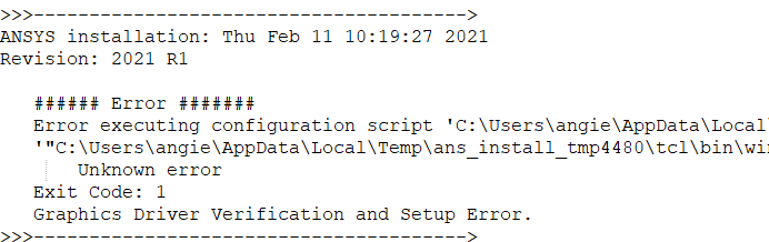

SubscriberFebruary 11, 2021 at 2:29 pmGeorge Karnos
Ansys EmployeeHello Angiekill1208,nvcruntime14_1.dll is part of the prerequisites installed.nThere may have been an issue with installing those.nWhen installing, did you right-click on setup.exe and choose more->run as administratornYou can also manually install the prerequisites nUnder the prereqs directory of the download you will see the Visual C++ install executables.nOr, you can download and install both the x86 and x64 versions of the Microsoft Visual C++ 2015 - 2019 Redistributable, that should resolve this provided you install both versions . . .nPlease let me know if this helps!nBest,nGeonnFebruary 11, 2021 at 2:43 pmANSYS_MMadore
Ansys EmployeeArrayPlease try reinstalling the Prerequisites from the Prereq directory of the installation media. Make sure you use Run as administrator to install.nFebruary 11, 2021 at 6:39 pmangiekill1208
SubscriberThanks for your help, nI have uninstalled, then re-installed the prerequisites from the prereq directory. After that I ran setup as admin. Something is still wrong. I took snips of the process log after setup completed. Notice the error message (image 3)?nn
Thanks so much for your continued help n
February 11, 2021 at 6:49 pmFebruary 11, 2021 at 8:12 pmangiekill1208
SubscriberArray , Array : I added a couple updates above, can you take a look , pleasennThanks nFebruary 12, 2021 at 10:37 pmangiekill1208
SubscriberI got it resolved. For anyone else having the same issue, here's what worked for me:nFollow method 4 from this link:https://softwarekeep.com/help-center/how-to-fix-the-vcruntime140dll-is-missing-error-on-windows-10nBUT use THIS .dll file downloadhttps://www.dll-files.com/vcruntime140_1.dll.htmlnCheers!nnViewing 6 reply threads- You must be logged in to reply to this topic.
