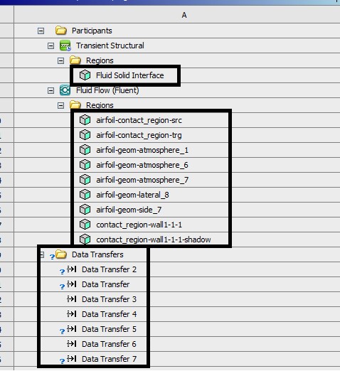

I am trying to simulate an airfoil in a free air stream with a Fliud Solid Interface model.
To perform an estructurate mesh I have built several regions around the airfoil: in Space Claim I havent substracted the airfoil from the surrounding air, but I have extruded everything from the sketch. Then I have added more regions of top, I haven´t used planes to cut the regions because it would have been much more difficult. When I checked the geometry in SC, no failure was found. Finally I set the contact to share to be able to impose boundary conditions correctly.
After having meshed successfully my model and set the Named Selections, I went to the set up module of fluent.
When trying to impose boundary conditions, it seems there are problems with two of the faces of the airfoil that I think the program does not know how to proceed with. What should I do here? I can not change them to wall, and they are missing from the airfoil wall. How should I treat them in Mesh interfaces?
Besides, when I am in the System Coupling settings, I have many more fluid regions than solid regions and I don´t know how to deal with the creation of the data transfers. Ideally, I would have 1 fluid and 1 solid region, which would correspond to the same surface of the airfoil. Is it possible to group all the fluid regions in one?
To sum up, my issues are:
1.-Existence of interface objects in fluent Setup module maybe coming from a wrong definition of Name Selections/ geometry building. How can I deal with it?
2.-Existance of many fluid regions for the data transfer pairing in the System Coupling tab that I don´t know either how to deal with.
Thanks in advance and sorry for the long message
