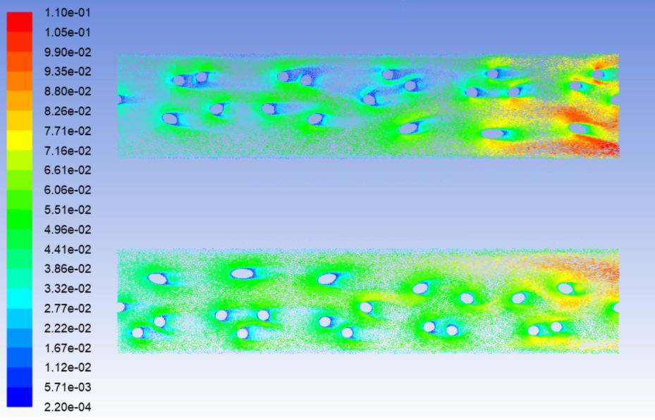

SubscriberDear all,n I am trying to simulate the thermal performance of a short part of the shell side of a helixal-bundled-tubes heat exchanger, the objective is to obtain the friction factor and Nu value under different Re values. I am using k-omega model, velocity inlet and pressure outlet, helium as working fluid, and constant wall flux boundary condition.n When I used steady model, the case diverged (absolute residuals oscillate and then increase before reaching 10e-3), then I choose transient model without any other setting changed, the case could converge well (absolute residuals reach 10e-4 and continuely decrease and then become stable in every time step) and I can see more details in the velocity profile when postprocessing.n I suppose the transient model will reach steady state after enough time steps. In my case, what is the reason of the different results of using steady model and transient model? Thanks a lot!n Best regards. -

SubscriberThanks for your reply! Could you explain what does pick up a transient in the flow field mean? nThe flow field in the steady case,nThe flow field in the transient case,n
There are eddies behind each tube in the transient case while the result of steady case does not show the eddies (even under a larger Re value).nI did not set point monitor, is it helpful? Thanks a lot.n
January 25, 2021 at 4:45 pm
Rob
Ansys EmployeeIn your model the cylinders are creating a wake. That then interacts with the downstream cylinder and it's wake. Read up on von Karman vortices and Coanda Effect. That will be inherently transient. In steady the solver is trying to work out which of the many combinations is the equilibrium state and failing: I'd normally expect poor convergence rather than a complete divergence in this scenario. nMonitors are covered in the tutorials and we use them to check for convergence in some cases: you plot a variable on a point/surface/volume with iteration (steady state) or time step (transient) to get more information on the flow field. n -

February 22, 2021 at 7:35 am
ywang2524
SubscriberSorry for the late reply, the high performance cluster in my university is really crowded these days and it takes several days to run my case. I found that the velocity distribution becomes more and more ununiform. Following are the velocity distribution at the surface x=0, you can see the maximum velocity becomes larger and larger with time while the minimum velocity becomes smaller and smaller.nt=1.25 s n
t=1.292627 snn The velocity distribution at the surface y=0 looks similar as that at the surface x=0 at t=1.25 s, while the distributions look quite different at t=1.292627 s, which is the last converged time step. n n
t=1.25 s n
t=1.292627 sn
some details of the high velocity area at t=1.292627 snn We have considered that maybe the cause is the low viscosity of helium under low temperature (30 K), however I have tried to set a large viscosity with all other parameters unchanged, and it did not solve the problem. We would be appreciated if you have any advice. Thanks so much!nn
February 22, 2021 at 11:58 am
Rob
Ansys EmployeeThat may be diverging, ie the solver is failing for some reason. Can you check the mesh quality in that region (cell quality and mesh resolution). Do you start to get back flow warnings at some point in the model? Are you converging every time step? There's a way of monitoring number of iterations per time step, look in reports. n -

SubscriberHi, I decreased the time step further to 5e-8 s and run several time steps, the overall solution does not get better. The velocity distribution on surface x=0 seems more normal, the velocity at most area is around 0.03 m/s, which is the inlet velocity. However, the velocity distribution on surface y=0 is abnormal, the velocity at most area is much smaller than the inlet velocity, and then increases sharply at the area near the outlet. Surface x=0 and surface y=0 are two vertical slices of the whole domain, why do they behave so different? Thanks so much!nvelocity distribution on surface y=0nnvelocity distribution at surface x=0n

February 26, 2021 at 11:47 am
Rob
Ansys EmployeeCan you turn on Higher Order Term Relaxation, HOTR. You'll need to go back a few saves to where the high velocity hasn't stated. It may be a case that the solution isn't stable and the higher order scheme needs some help. n -
March 2, 2021 at 6:33 am
ywang2524
SubscriberHi, I turned on HOTR and it does help, now I can arrive at 1.3 s using a time step 10e-4 s and still wait for more results, so could you please explain more about how HOTR helps? Thanks a lot!n -
March 2, 2021 at 11:50 am
Rob
Ansys EmployeeIt's a blending function, so where the solution is very stiff it'll relax to a nearer first order solution. In the old days we started all models with first order discretisation and if the convergence was good would try second (or similar) order to improve the accuracy. With the newer solvers we just launch with higher order and use HOTR to help with convergence. n -
