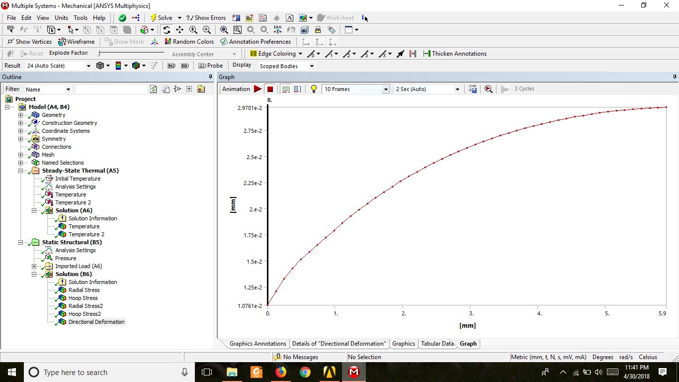

      I have attached the model i tried last time.
      Put 10MPa pressure on the inner line of the cylinder and inner line temperature 1100 and outer line temperature 100.
      And then teach me how can i get the residual stresses , deformation graph(like the above attached photo already).

      Here is a graph of radial displacement from your model in red averaging about 0.024 mm, while the value of the line for the 1000-100 condition that I read off the u plot from the book above is about 1.7 mm and I plotted that with a green line. The green line is a factor of about 70 times larger than the red line.
      The enormous difference between the value of the plot in the book and the value in your model is conclusive evidence that your model does not reproduce the physics that are in the book.
      If you are interested in reproducing the results in the book with an ANSYS model, then you have to show for the numerical model in the book all of the following: the mathematical model, the assumptions made by the mathematical model, the inputs to the numerical model, the time-history of the materials in the numerical model.  Where does it say in the book that residual stresses are being plotted in the stress plot? I asked about the temperature during bonding of the layers. Where is that information?

      Can you please show me how to produce this graph from my model?
      And sir i will know you the other information as soon as possible.I am studying about your doubts.
    • peteroznewman
      I used JMP to make the plot, but if you have Excel, you can make a similar plot.  Highlight the Tabular Data in the Deformation result for the Path, copy and paste into Excel.  Add a column to divide the path length by the maximum radius to create the Non-Dimensional Radius. Make a scatterplot of Radial Deformation vs Non-Dimensional Radius and add another Data Series in Excel that has the value 1.7 and you will have it.

      Another thing i tried to get the deformation to get a graph like you.But failed.I tried to get the  Radial Deformation vs Non-Dimensional Radius graph like this
      But got this kind of graph which is like this curve going upwards
    • peteroznewman
      In Excel, insert column B and use a formula to divide column A by 5.9
      Forget about the data curving up or down a little bit, the magnitude is wrong by a factor of 70.
